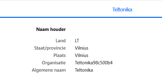

While browsing to my router, it still shows the Teltonika certificate, why?
This is what fire showned:
Further looking, it seems that this certificate already expired on June 13th 2021.
What can I do? How can I correct this?
