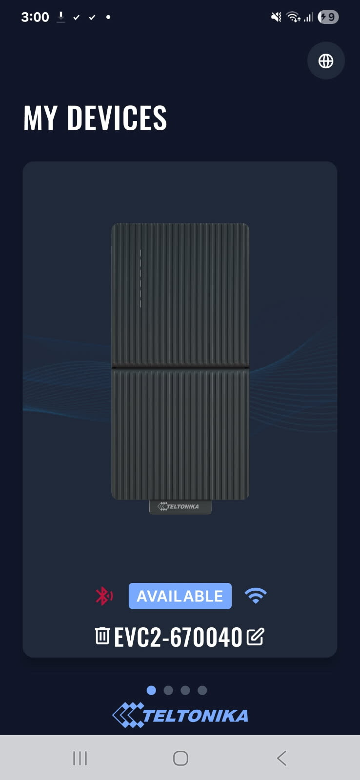

My apologies about possible misleading you. Right now this function works only with Android phones as this function temporarily disabled on iOS devices as we noticed undesired workflow. As how long it will remain disabled on iOS I cannot say, but engineers working to resolve this as soon as possible. As for feature itself, I am adding photo of Android device:
As you can see, there two new icons next to device status indicating both connection types and their availability. On this Android phone, I have BT connection turned off and local wifi network on. You can connect to the device as long as you remain on the same network. Keep in mind that for the first time, at least currently, you still have to connect to the wifi.
If you are using Android device and having issues connecting using local network, please let us know.
