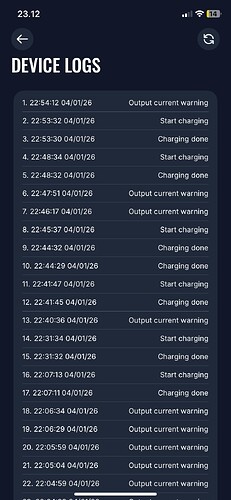

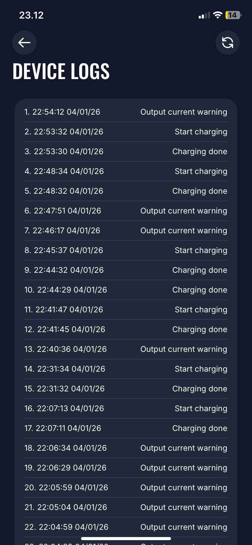

I have EVC11 model. In app’s diagnostics/device logs I keep getting warning message ‘output current warning’. What is this message? it is not listed in wiki warnings section. I keep getting it and I wonder is that an issue?
I had charging overnight stopped few times by car and I have been troubleshooting it. I have cleaned cable and ports and problem has not appeared again but I am not sure if problem is fully solved. Therefore I started to investigate device logs.
Also does the messages “charging done’ and ‘start charging’ relate to load balancing and switching of phases? (I have Carlo Gavazzi meter).
Is this device log normal messaging? Should I be concerned and if, what should be done?
This can indicate a few issues with the station, starting from minor issues with grid to motherboard components failure. For us to provide correct information, maybe it would be possible to send us data log file from EVC station? This would allow us to give you correct answer.
