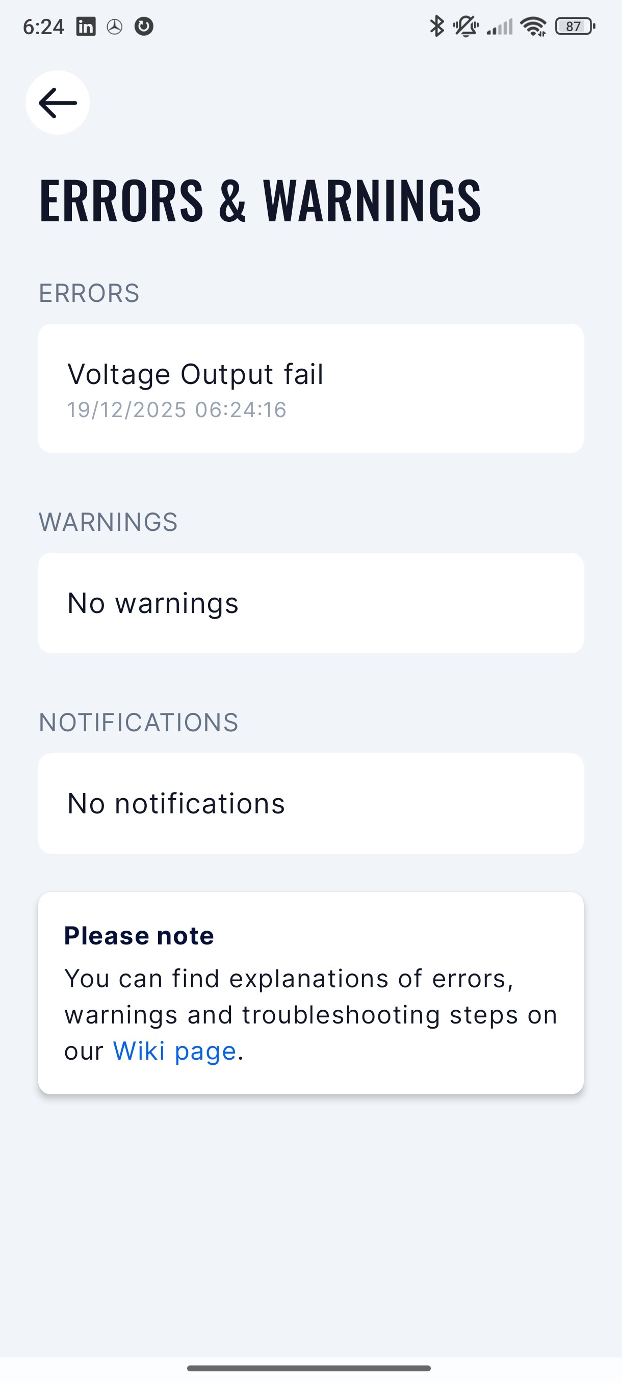

Voltage output fail
During charging 2-4 times per hour it shows Voltage output fail message and charging stops, it stops to charge for some time and later on continues to charge and it happens every time i charge car.
How it can be solved ?
