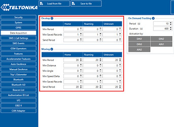

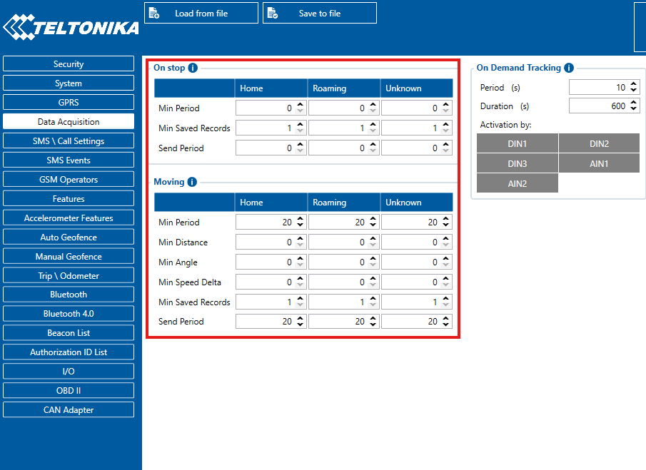

Hi @normel,
I hope you are doing well. You may try the Configuration below for the device’s Data Acquisition settings, where when the vehicle is On Moving, it would ping every 20 seconds while when it is parked/On Stop, no data will be sent to the server.
You may try to test on one of your devices.
