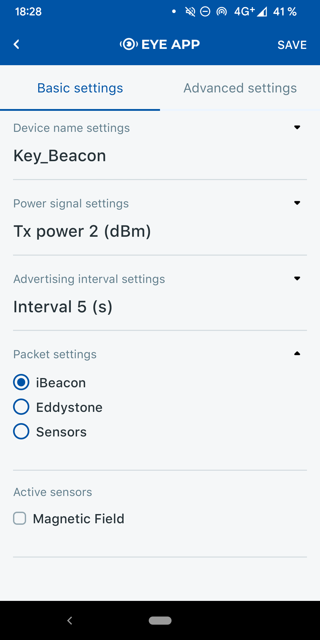

The remote GPRS commands for blocking/unblocking the engine work, but the Immobilization-Feature of the FMM130 does not. I want the engine to be automatically blocked, if the authorized Eye Beacon is out of range. However I can only define a DOUT, not the CAN blocking/unblocking command.
However, when I put the Eye Beacon to sleep with the Eye App, it won’t block the engine, as I would expect… Or is there a different way, how to trigger the “out of range”-event?

I beacon will only work for immobilizer using the device’s feature , check the below screenshot for more clarity

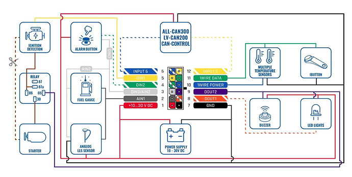

Thanks Maryam. So basically I need to install the starter relay, connect it to DIN1 for ignition detection and it is not possible to use CAN-CONTROL instead, as I expected?
The CAN-Control can also be used for immobilizer ; however, it requires connection to the CAN-line of vehicle , also it needs to be connected to the vehicle according the the wiring diagram which will suppose to provided by Teltonika support for the correct setup.
Further you need to send commands for lock/unlock
Check the list of supported vehicle from link https://wiki.teltonika-gps.com/images/1/1a/CAN-CONTROL_IMMO_2024_05_15_en.xlsx
For immobilizer using the device only ,
  1. To control the engine, connect a relay to the DOUT and Din of the device.
  2. For authorization, you can connect an iBeacon.
Find the below wiring diagram for reference
