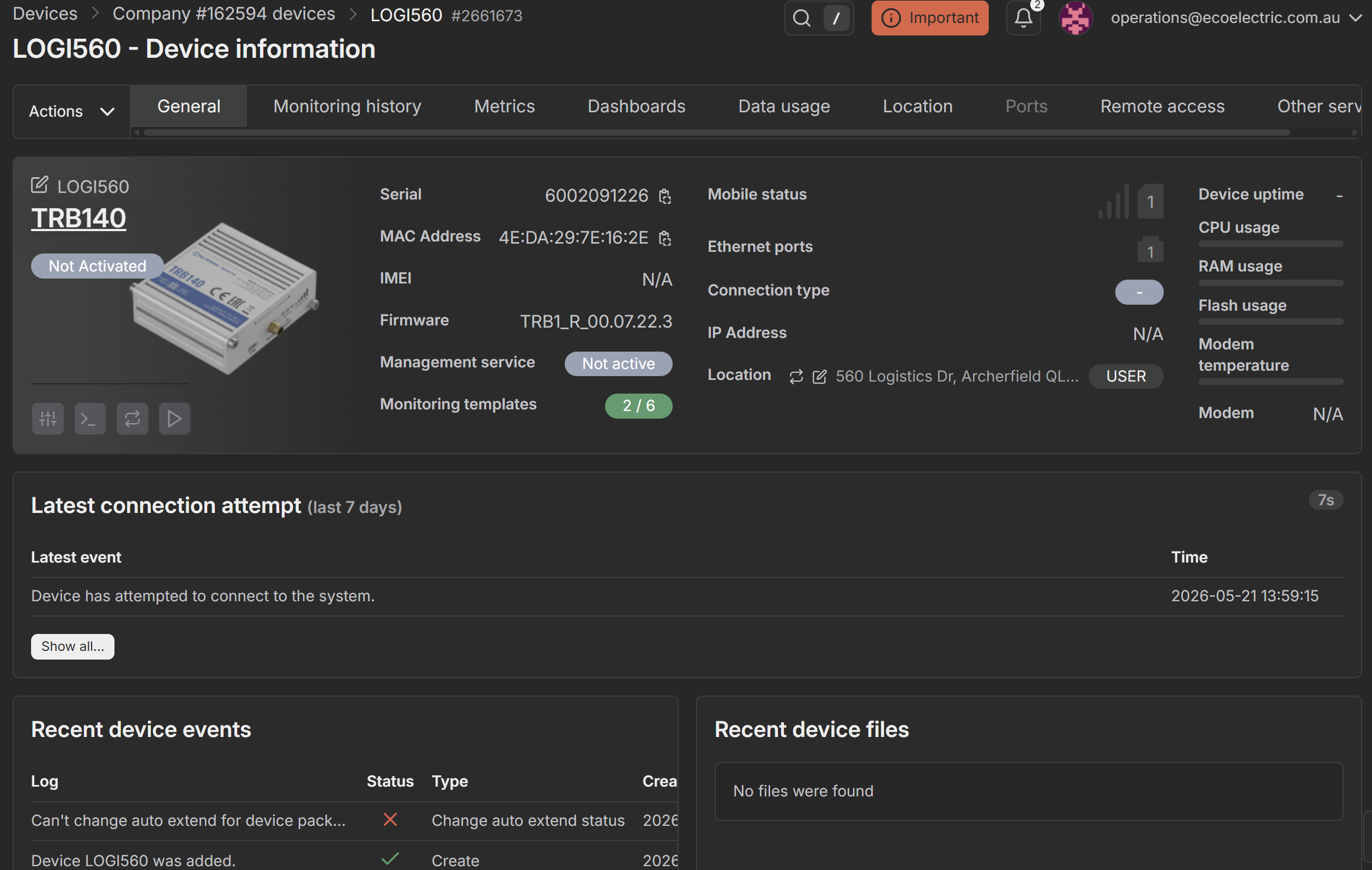

I have installed the device. I have installed a SIM.
Internet is working.

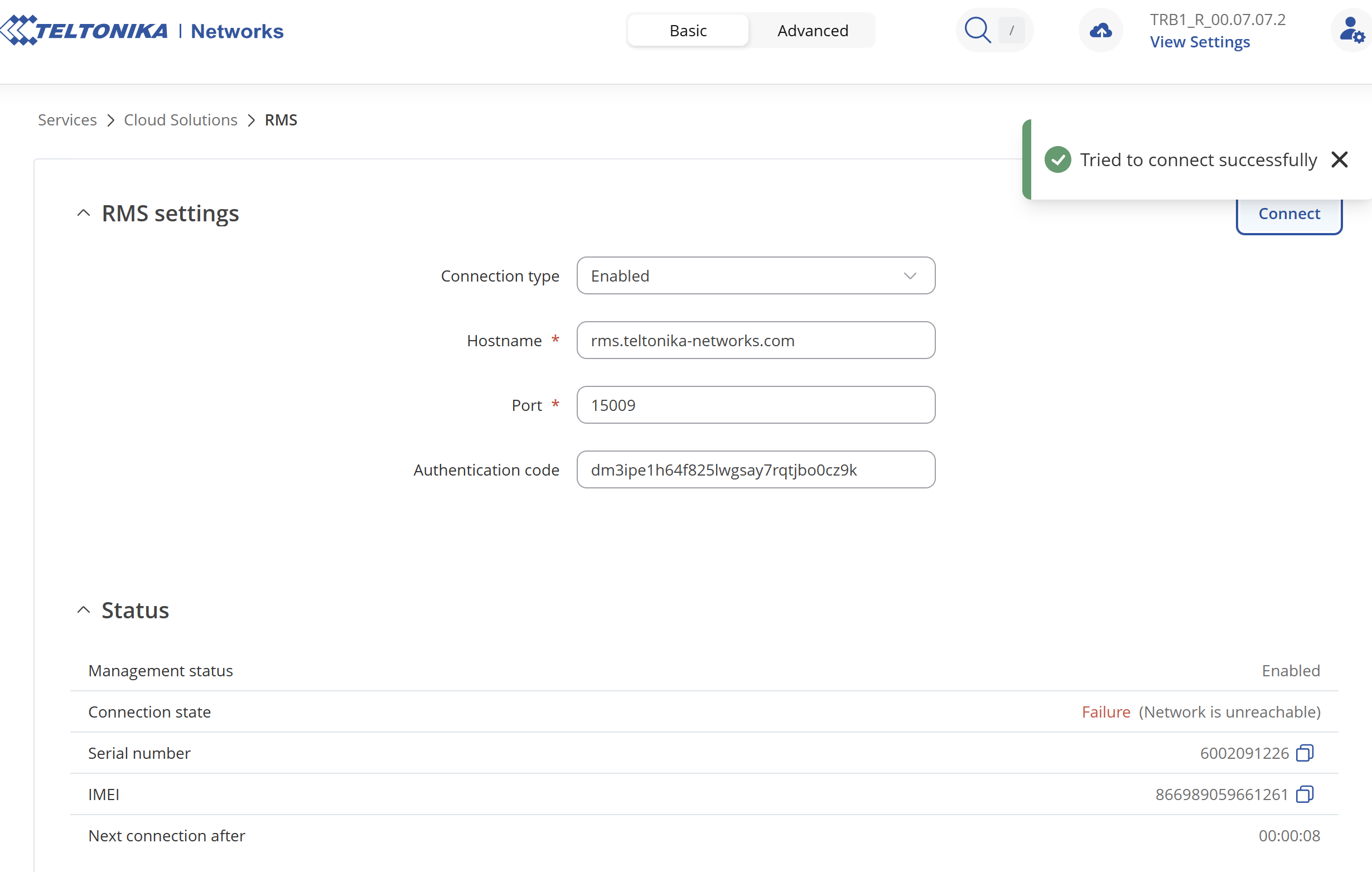

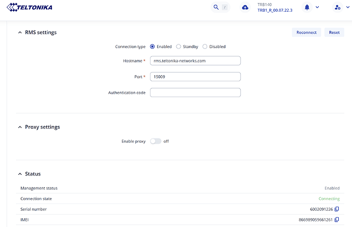

I have enabled RMS in the TRB140
I have updated the firmware and the system time/date
I have changed the admin password to one that matches basic password requirements
I have tried connecting with an authentication code and or without

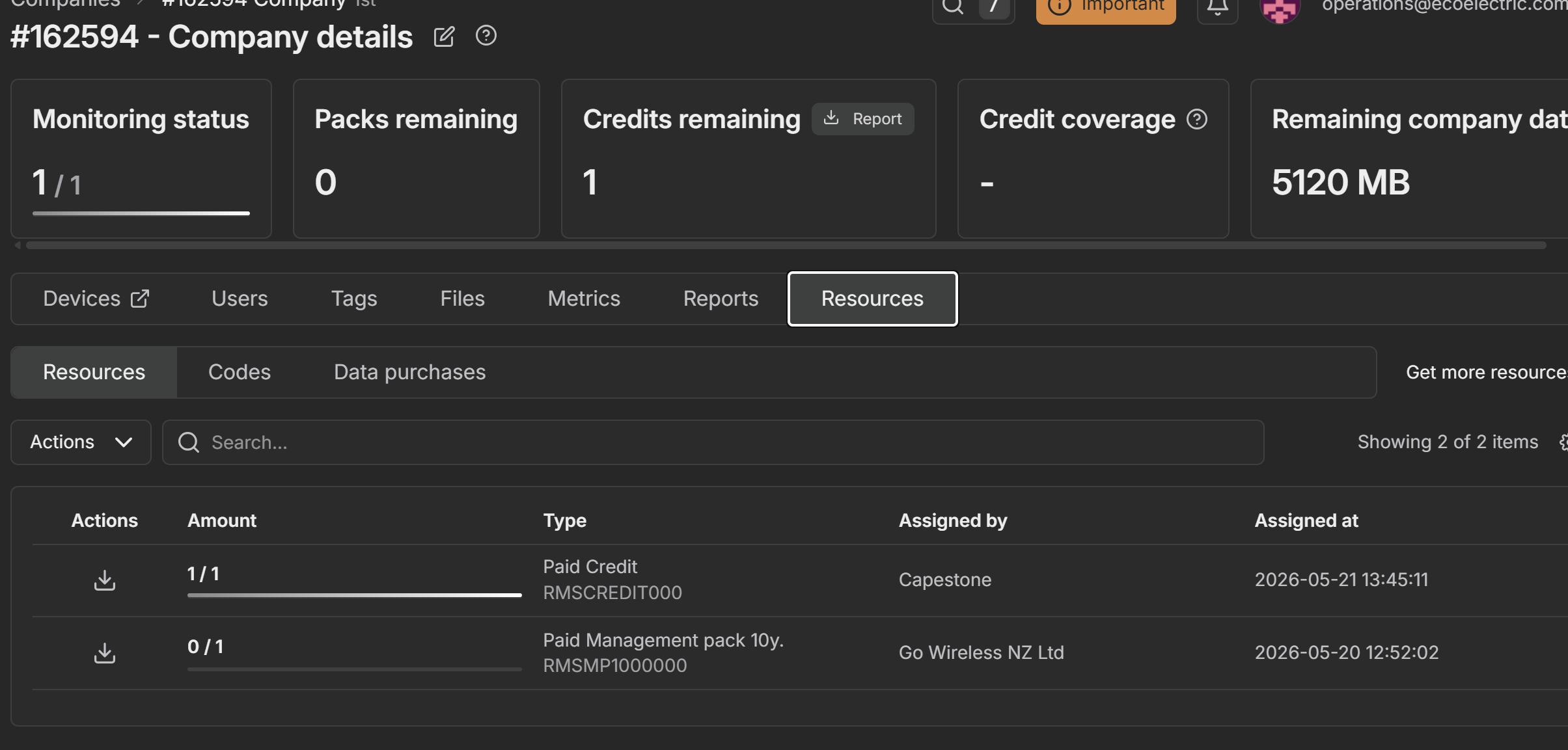

In RMS I have added and removed the device.
I have purchased a 10 year management pack
I have purchased a credit
These look like they are assigned.

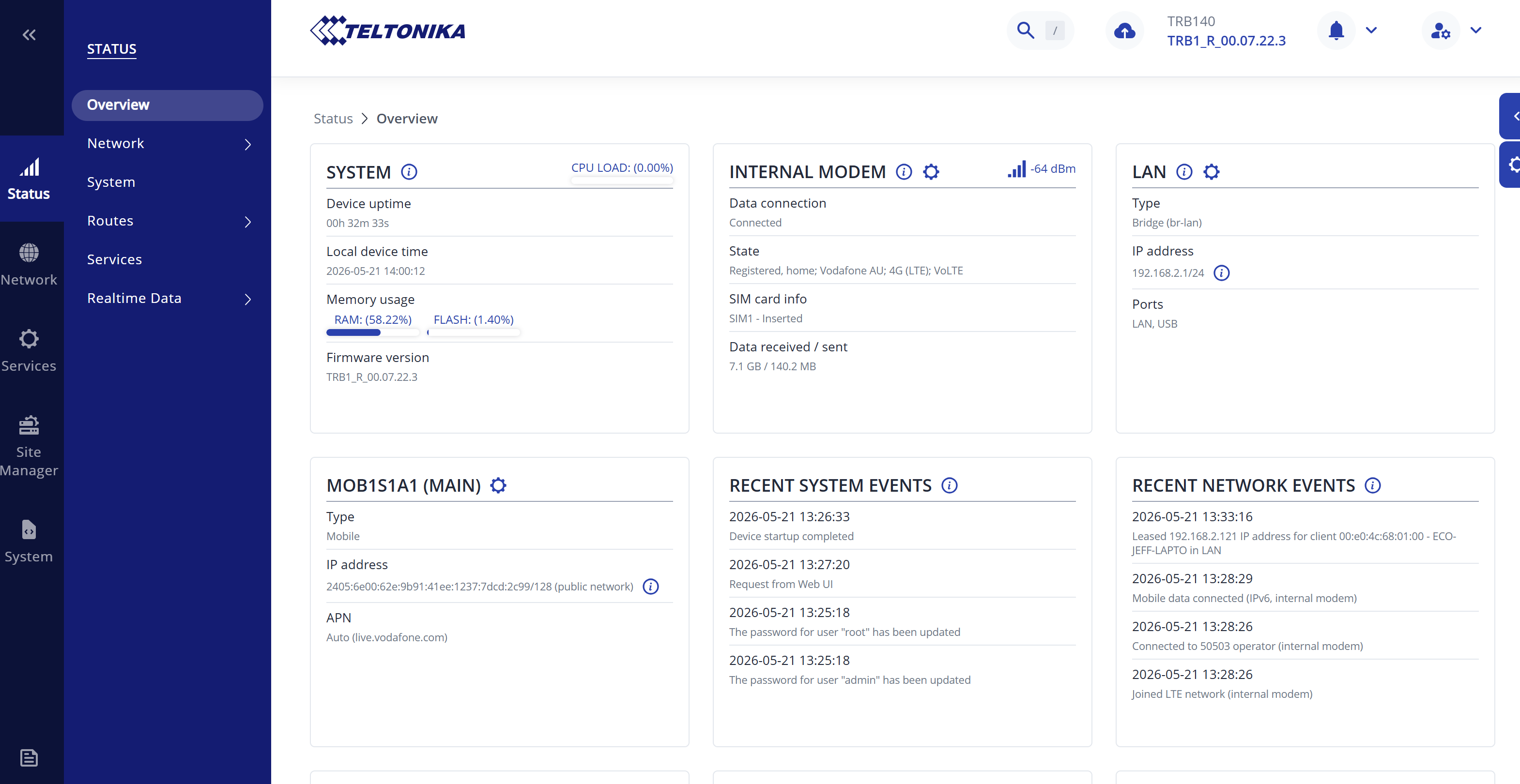

I tried pinging via TRB140 CLI - all good
This all seems incredibly difficult. How do I get this to connect? I need a quick setup process before we can consider this for a rollout. At this stage Ive spent 5 hours most of which is on site to connect 1 device.

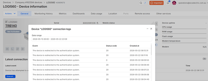

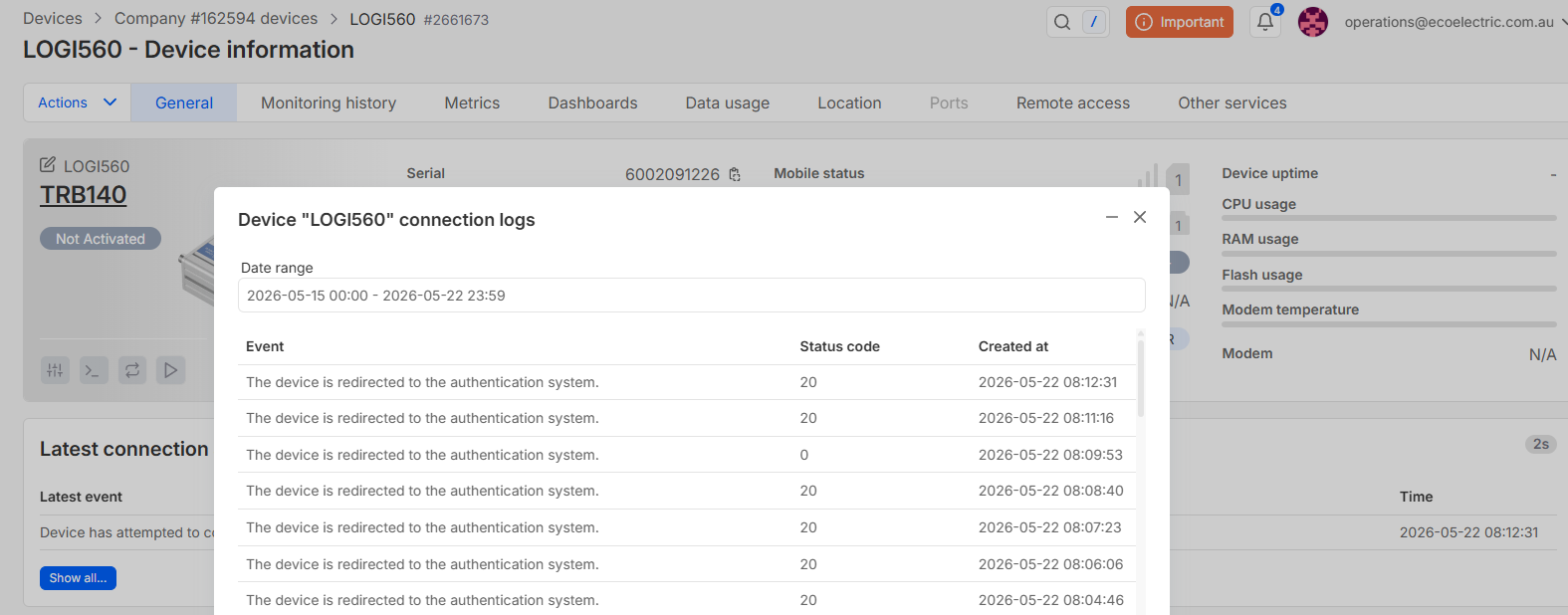

OK I think I have the packs sorted - now it is saying it is been redirected to authetication system?
When I click verify device I am entering the same password used to login to the UI on the device itself ie admin/root password?
