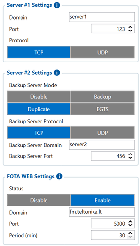

Maybe you can use the FOTA Teltonika platform to change the configuration to include a second server. If all the trackers have the same configuration, you can make this update using a bulk operation. Use the backup server mode as “duplicate”. After updates, you will configure the new telematics platform. When the configuration is done, you can update the configuration to remove your old server.
