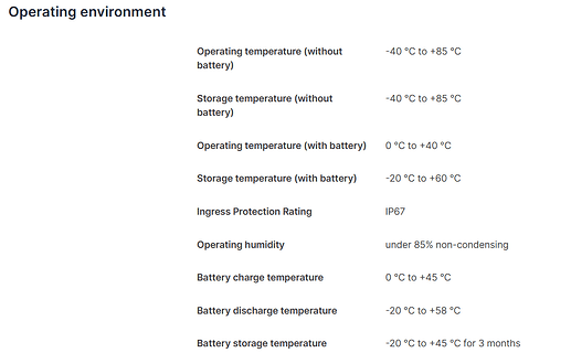

What is the high temperature value at which the TMT250 shuts down?
It appears to shut down if left in the sun and does not restart when the temperature drops.
Is it possible to set it to restart, if not maybe in future firmware.
Dear @Mako,
I hope you are doing well. You may refer on this link for the TMT250 Datasheet related to the device’s Operating Environment: TMT250 – Mini GPS Tracker For Personal Security
Currently, for Power ON you need to configure the device to which button you need to press. Suggesting you to enable the Power Off/On notification so you would be informed when the device goes to ON/OFF, for more information you may refer to this link: TMT250 Features settings - Teltonika Telematics Wiki
