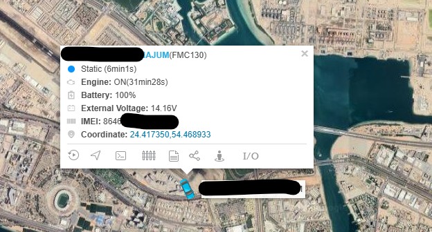

The name of the Driver does not appear on my tracking system why? Use fmc130?

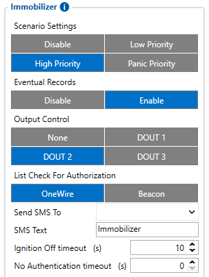

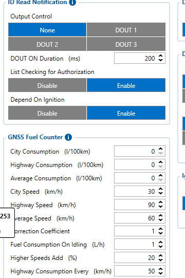

I installed a iButton and Immobilizer to identify him on the fmc130 and made the following settings on him for the purpose of the driver’s name appearing on the control panel :
But I didn’t show up like this picture:

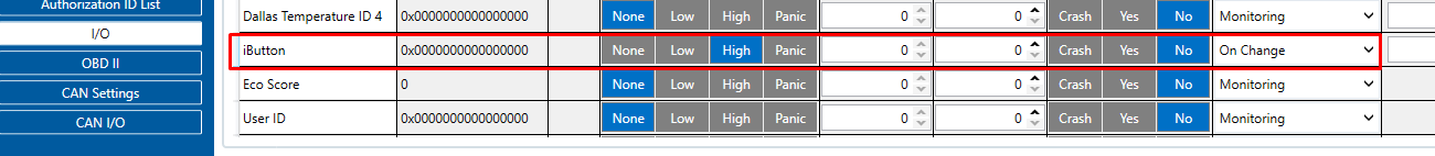

Please enable the ibutton IO from the device.
Check for AVL ID 78

I made this move beforehand, but to no avail.
