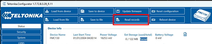

Hello
you can do it when you connect to the device via bluetooth from the configurator
from this button, you can read the old data which haven’t been sent to the server and saved in the device,
So, what I understand is:
After making the necessary adjustment,
if there is unsent packet data for 10 minutes,
when I send the command “sms_dbg: radio 900” on the Bluetooth side,
will I receive multiple packet data?
Or will I get the current status information of the device at that moment?
