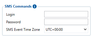

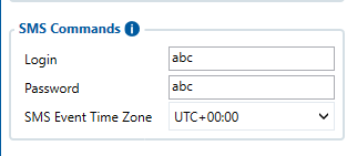

If you are going to send @sms_dbg:getinfo make sure that you put 2 spaces after @sms_dbg: if you didn’t configure the username and password for SMS commands
For example:
@sms_dbg:abc abc getinfo
@sms_dbg: getinfo

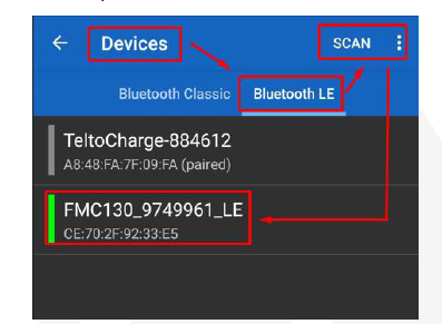

Please connect using GATT protocol or Bluetooth LE
Regards
Maynard C

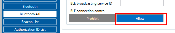

Also, make sure that you selected allow from the BLE connection Control

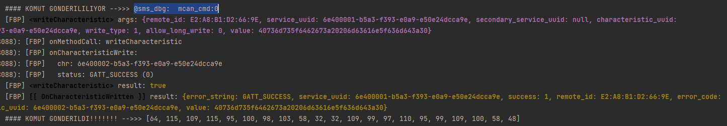

I sent you a screenshot.
Here it says GATT_SUCCESS, meaning access to the device and sending commands are successful.
But there is no reaction in the device. When I send a request to the device from UART mode with a different application, the device reacts successfully with commands etc.
“error_string”:“GATT_SUCCESS”,
“service_uuid”:6e400001-b5a3-f393-e0a9-e50e24dcca9e,
“success”:1,
“remote_id”:“E2”:“A8”:“B1”:“D2”:“66”:9E,
“error_code”:0,
“characteristic_uuid”:6e400002-b5a3-f393-e0a9-e50e24dcca9e,
“value”:40736d735f6462673a20206d63616e5f636d643a30
value = 40736d735f6462673a20206d63616e5f636d643a30
ValueToString : @sms_dbg: mcan_cmd:0
Thank you!
Hello!!
@sms_dbg: mcan_cmd:0\n”
It was necessary to complete 22 bytes. I provided the solution by adding a space character at the end of the commands. All commands are working now.
