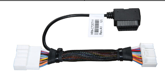

You need a converter like the photo below to connect our OBD device.
