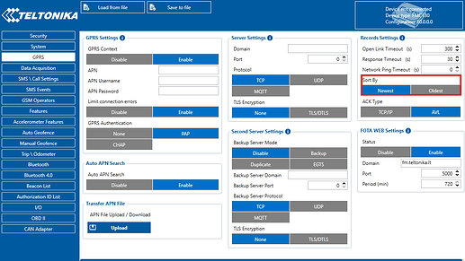

Thankyou @Patrick_Sangalang kindly provide screenshot of achieving the above…
Hello @Daggy_sanya,
Attached is the screenshot for the Sort By settings:
Patrick
