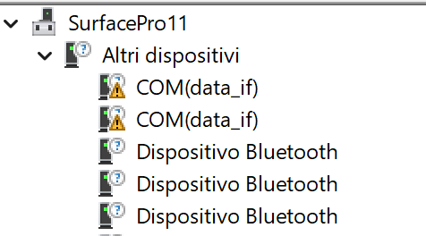

I’m trying to use an Arm64 Win11 machine with Configurator but drivers seems not installed.
Trying to do a manual driver install doesn’t solve.
How can we solve?
It’s the 1st and unique device type with driver problems on Arm64 Win11. I’ve many other devices like USB Uart interfaces and works as expected.
Thanks.

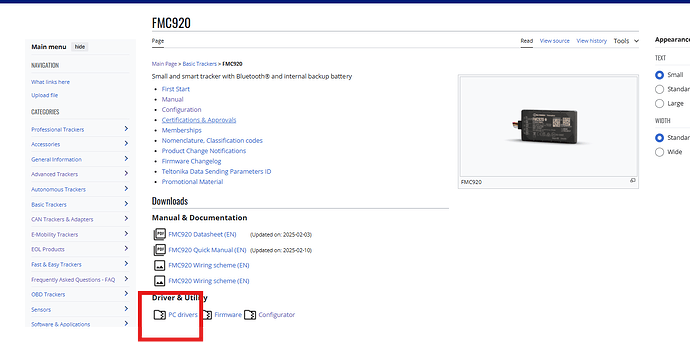

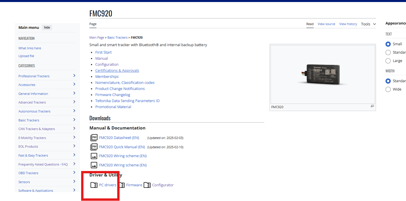

Good Day,
Kindly download and install the drivers from the device wiki page as it can be seen in the image below:
Thanks, and best regards,
Imran S.
Obiviously I’ve tried but the driver are only for x86 and x86_64 architectures.
Please read carefully my initial post.
For those are suffering the same problem on ARM64 PCs a workaround is to force windows to use their usb2ser standard drivers.
After that Teltonika Configurator will find the device and works as expected.
