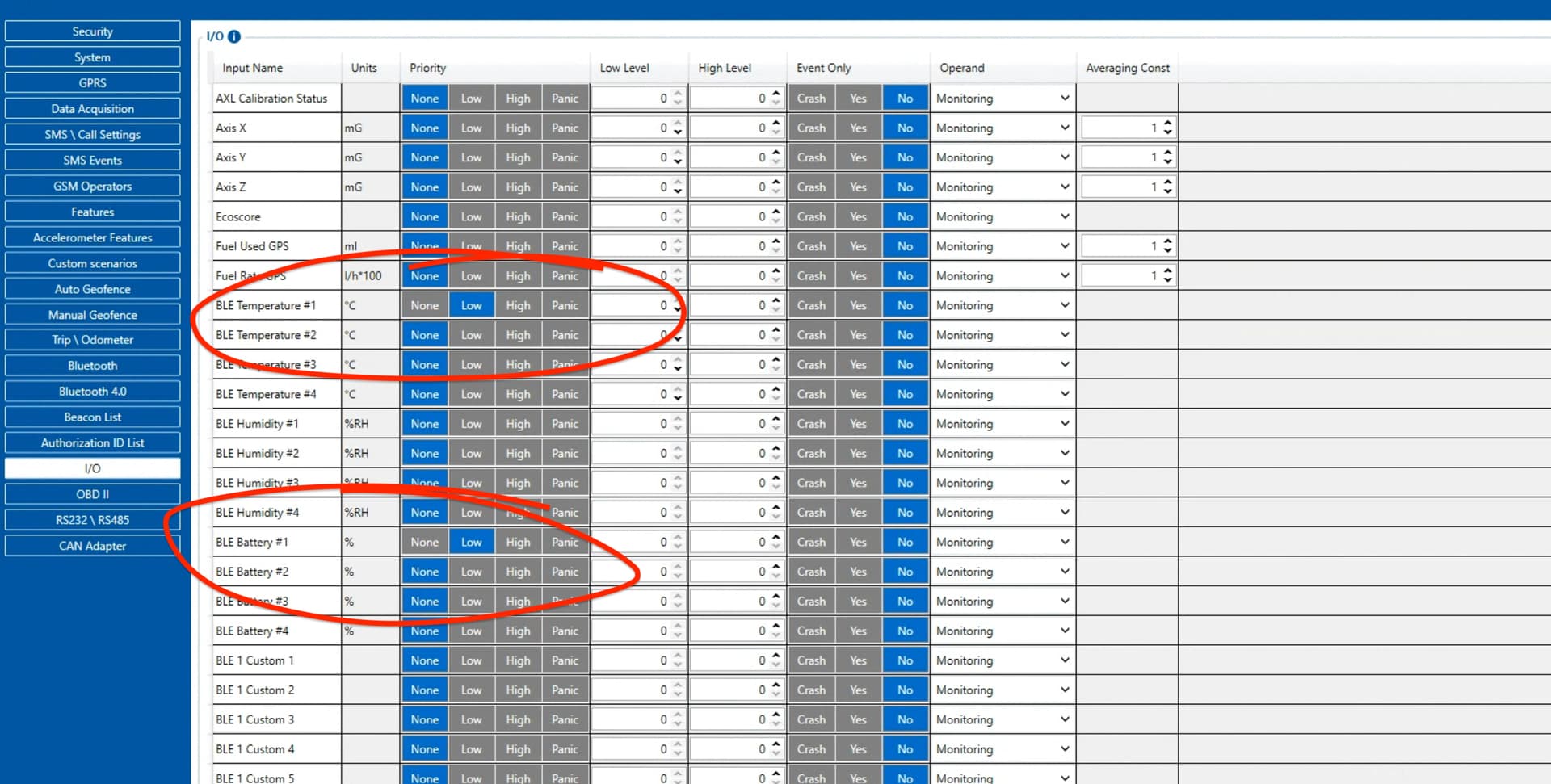

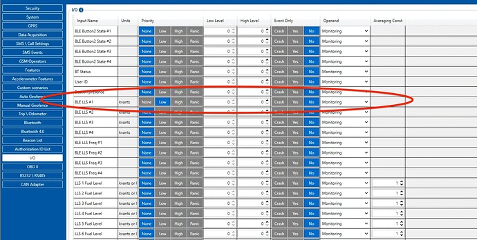

We’re using Eskortnitsa TD-BLE fuel-level sensors with a different Teltonika model, but the configuration will be the same. There is no need to scan, just enter the MAC address (printed on the sensor) and data decoding schema as below:
In I/O, make sure to set the parameters, so your Teltonika device will send the fuel-level data. Otherwise it will collect but do nothing.
None - don’t send
Low - send together with other data as per your scheme in “Data Acquisition”
High - send every time a message is received from the TD-BLE
Panic - I think this tells the device to make a phone call/send SMS. I’ve never used it.

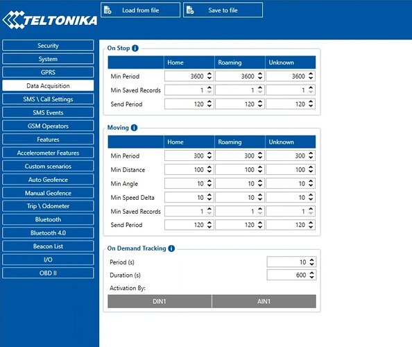

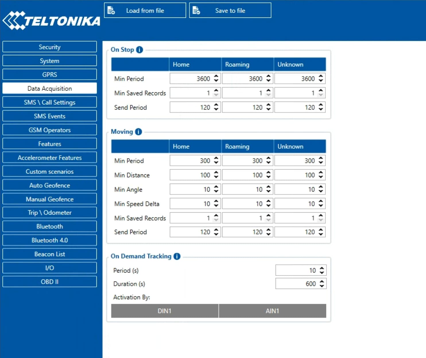

The default settings in “Data Acquisition” are very slow for stopped devices. The tracker may not send for up to one hour (3600 seconds).
You may wish to adjust the sending frequency.
