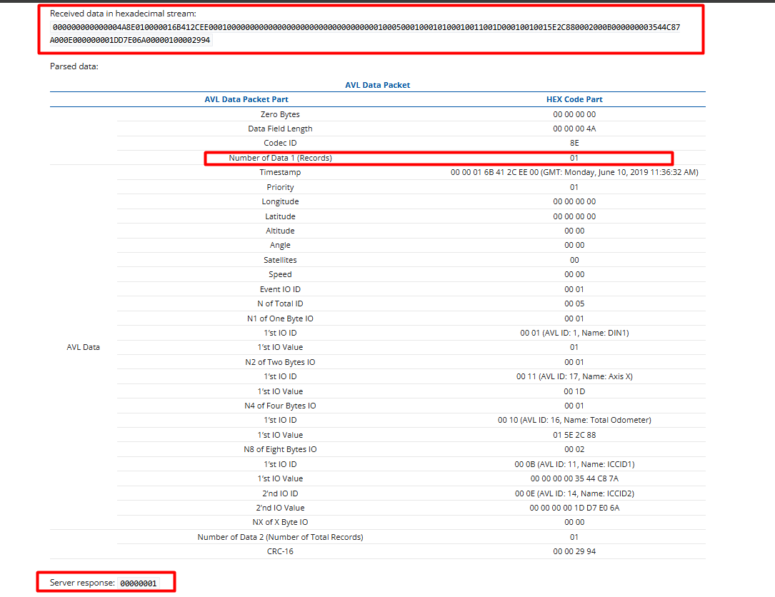

This is due to the wrong server response,
The server should respond to the device after every record received from the device, In this case, if the response is correct, then the device will delete this record from the storage and send the newest ones
BR
Laith
Thank you, this was the issue with our server. We added the logic to respond to the TAT240 and it solved the issue.
