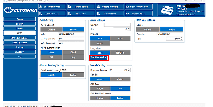

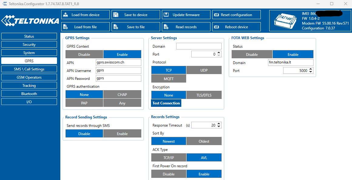

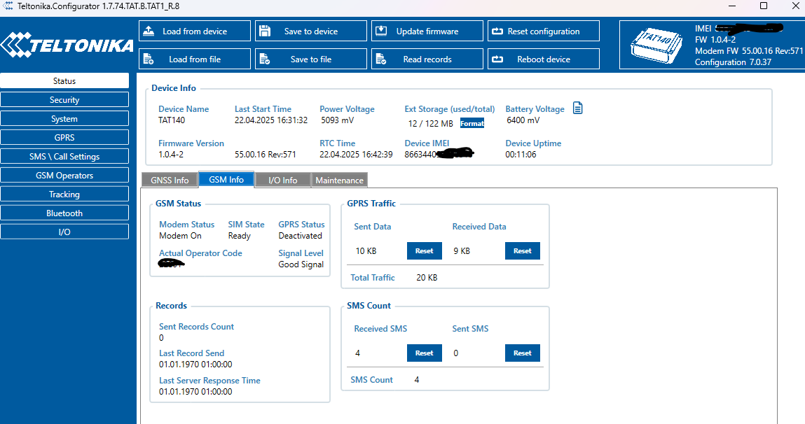

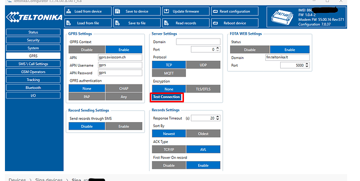

Hi, I bought a TAT140, I have inserted the SIM-Card, without PIN. I have tested the SIM-Card in my iPhone and it is working. I have configured the GPRS Settings, when i try on the server settings the test connect I receive the message “comand sent sucessfully”. But my device don’t go online. Who can help me? I would like to programm one app to tracke my dog, for them I need to access to the device with the API.
For your testing you can try to use https://flespi.io/login
create an account, configure the server settings after that click the Test Connection So that the modem will activate and send the data to the server. By default modem is in sleep mode to save the battery of the device.
