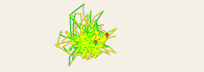

I have an FMB 240 on a generator, but when the engine is running, it doesn’t switch to static mode and gives inaccurate positions, even though the generator is stationary.

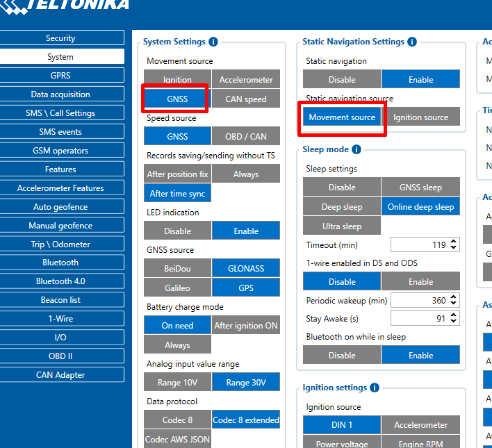

Please try to set the movement source as GNSS and the static navigation source as movement
