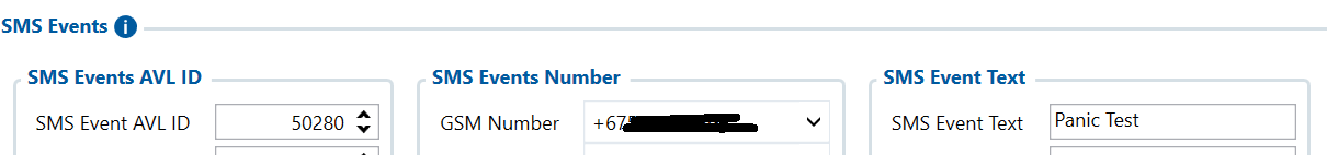

I have Digital Input 3 set up for the SOS trigger so when DIN3 changes to 1 it activates the SOS.
Now i want this sent directly from the Device (FMC130) to my mobile number
Ive input the information. (note ive blurred out my number)
ive triggered it and although DIN3 is changing from 0 to 1 i am not receiving an SMS. i must have done something wrong and need help
g)
This has been solved. the SMS Event AVL ID must be set to 3 as DIN3 is SOS
Hello @romankili,
I hope you are doing well. Yes, you need to use the AVL ID based on the Data Sending Parameter ID and not from the device Parameter List.
To get to know more about the complete AVL ID list, you may refer to this link: FMC130 Teltonika Data Sending Parameters ID - Teltonika Telematics Wiki
I hope you have a great day ahead!
