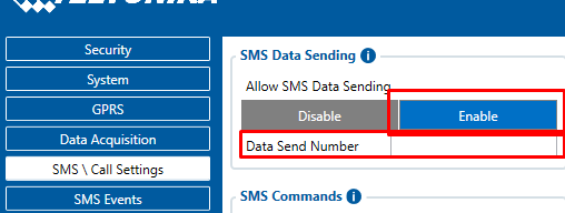

Did you enable the allow data sending.

data sending via sms is disabled

The device will not send an SMS response to your phone unless you send a command or enabled the SMS data sending when the Panic priority mode was activated.
