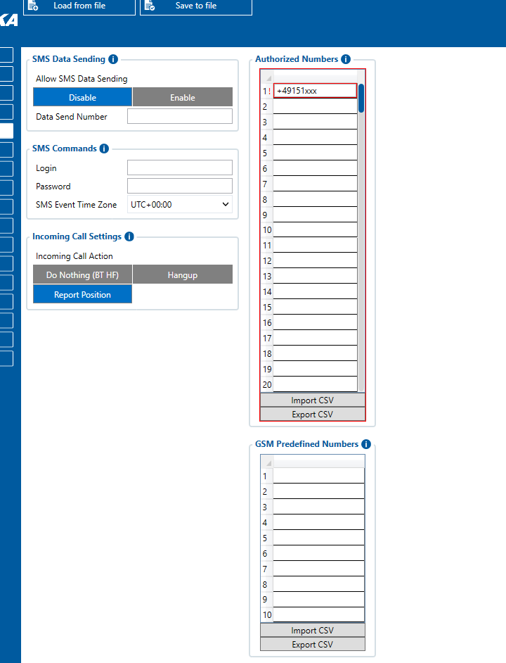

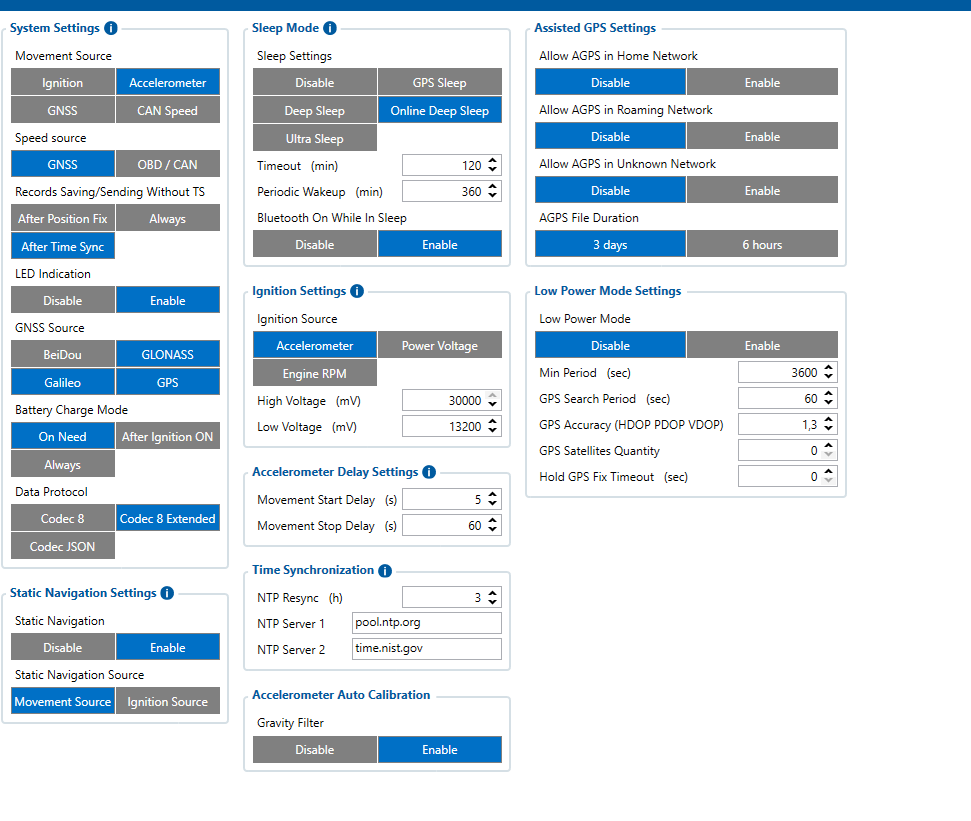

Hey people currently I am trying to get the SMS commands to work for my FMC 003 / FMM880. If I send a SMS to the SIM card I get no response at all. No password, username set. Tried to add my number to the authorized numbers list but even this would not make a change.
Settings:
(Online deep sleep)
Maybe someone else can help me troubleshooting

What is the command that you are sending? And how do you send it?
Sometimes the device will perform the command and not send a response, this is due to the SIM card package
