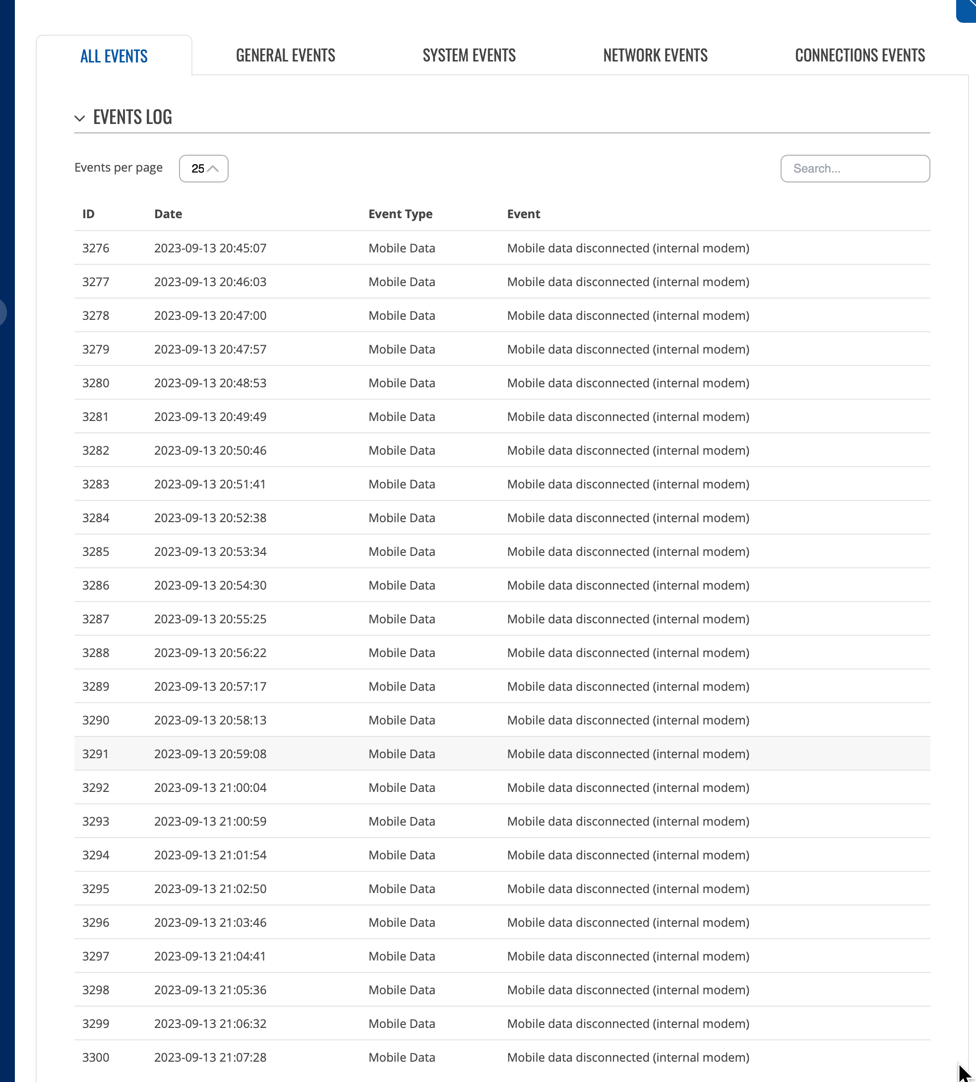

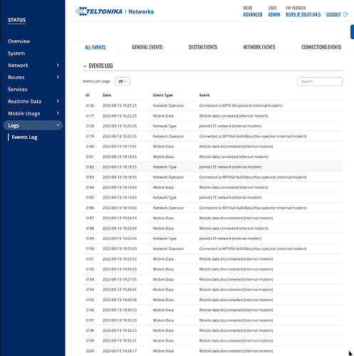

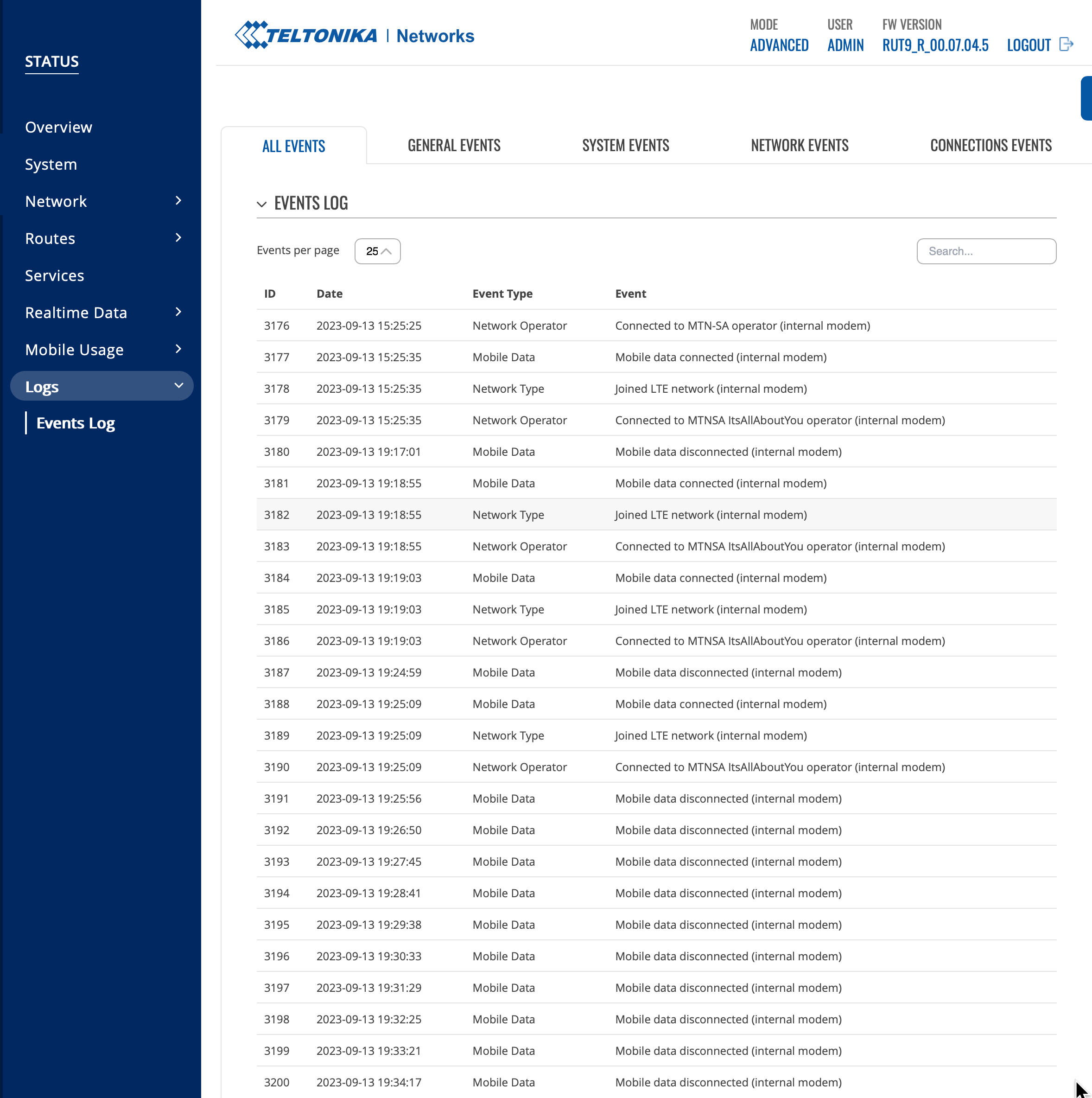

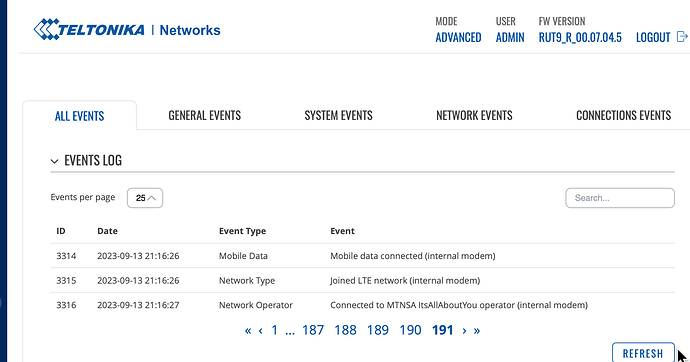

RUT950 keeps disconnecting, despite 4G presence
What internal modem firmware version do you have? Same as mine?
@oscalot
The logs are full of hostapd - wlan logs. This is related to wireless WiFi and not to mobile connection. Maybe you have more logs to share?
@Bernd
Would it be possible for you to provide a bit more information? For example, you mentioned that the router is three years old. Was it working fine before that? Did the issues start to occur only now?
Do you have any configurations on the device related to mobile? Maybe you have failover / SIM switch configured, or data limits?
Could you please provide some system logs from System → Adminsitration → Troubleshoot → ‘View’ system logs? Also, some screenshots from Status → Overview and Status → Network → Mobile. Before sharing this information, make sure to blur/hide any sensitive information, such as IMEI, IMSI, etc.
My Modem Firmware is EC25ECGAR06A09M1G_01.001.01.001
Router is monitored on https://rms.teltonika-networks.com - can you access and look the logs yourself?
If yes, which information you need?
@Bernd
If you would like us to take a look at your device through the RMS, we would need some additional information about you, including information about your RMS account. Due to public nature of this forum, it is not possible for us to communicate privately (or share files, such as troubleshoot files). You would need to contact your designated sales manager or reseller from whom you purchased the device. If this is not feasible, you can fill in the ‘contact us’ form here. This way, there will be a way for us to exchange information and the team will be able to look into the issue.

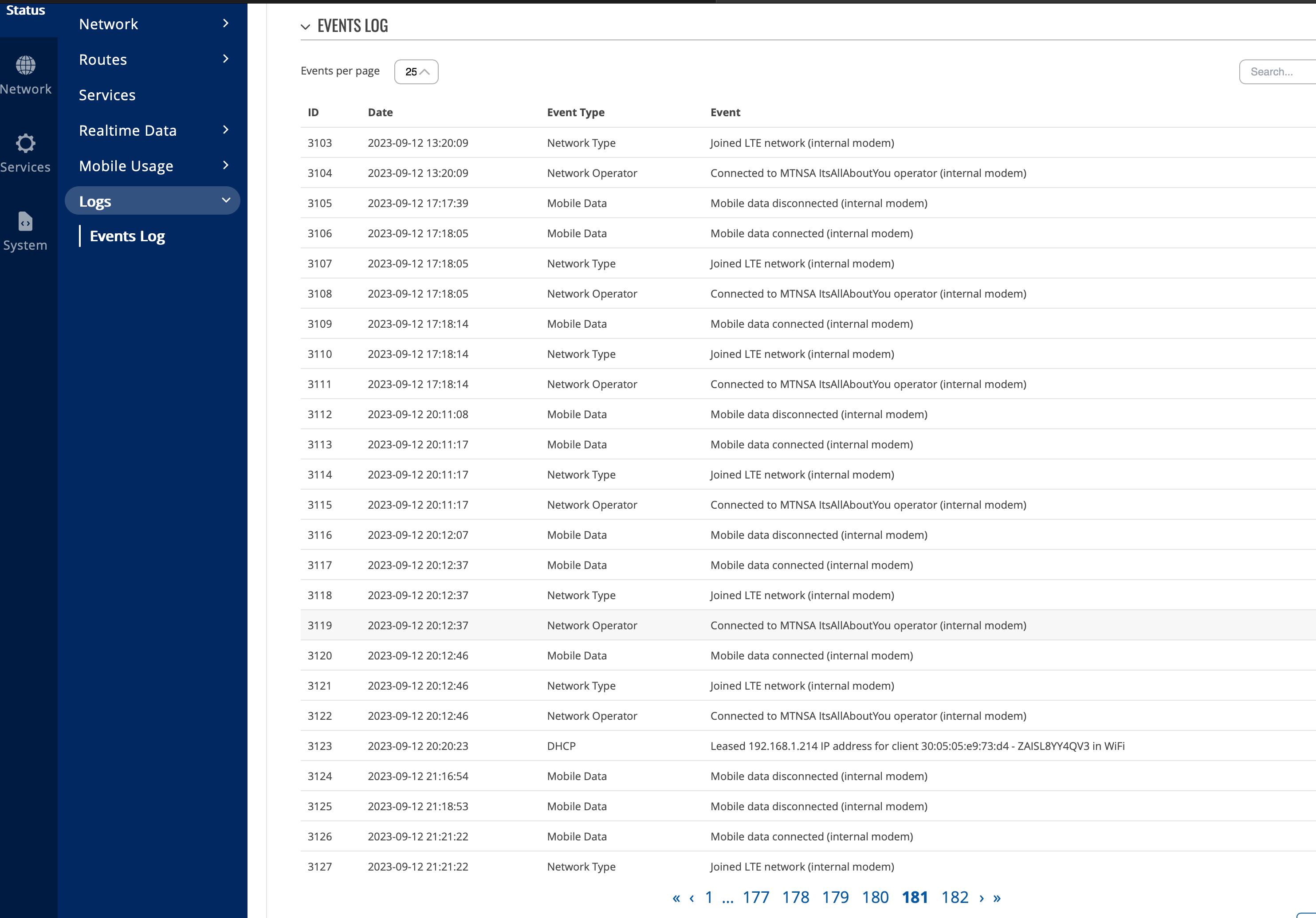

Hello, these logs show short intervals between “connected” and “disconnected”. Normally these are stuck in “disconnected” until I reboot the router. I will see if there are other logs and post them…
Tue Sep 12 20:11:01 2023 daemon.notice netifd: mob1s1a1 (24682): Request timed out
Tue Sep 12 20:11:01 2023 daemon.notice netifd: mob1s1a1 (24682): Mobile connection lost!
Tue Sep 12 20:11:01 2023 daemon.notice netifd: Interface ‘mob1s1a1’ has lost the connection
Tue Sep 12 20:11:02 2023 daemon.notice netifd: mob1s1a1 (23305): Stopping network mob1s1a1
Tue Sep 12 20:11:02 2023 daemon.notice netifd: mob1s1a1 (23305): Stopping network on /dev/cdc-wdm0!
Tue Sep 12 20:11:02 2023 user.notice netifd: uqmi -s -d /dev/cdc-wdm0 -t 3000 --set-client-id wds,1 --stop-network 0xFFFFFFFF --autoconnect
Tue Sep 12 20:11:03 2023 user.warn mwan3-hotplug[23304]: hotplug called on mob1s1a1 before mwan3 has been set up
Tue Sep 12 20:11:05 2023 daemon.notice netifd: mob1s1a1 (23305): Request timed out
Tue Sep 12 20:11:05 2023 daemon.notice netifd: mob1s1a1 (23305): “Unknown error”
Tue Sep 12 20:11:05 2023 user.notice mobile.sh: Received unknown error(1/5): “Unknown error”
Tue Sep 12 20:11:05 2023 daemon.notice netifd: mob1s1a1 (23305): Releasing client-id 1 on /dev/cdc-wdm0
Tue Sep 12 20:11:05 2023 user.notice netifd: uqmi -s -d /dev/cdc-wdm0 -t 3000 --set-client-id wds,1 --release-client-id wds
Tue Sep 12 20:11:07 2023 daemon.info dnsmasq[3428]: read /etc/hosts - 4 addresses
Tue Sep 12 20:11:07 2023 daemon.info dnsmasq[3428]: read /tmp/hosts/dhcp.cfg01411c - 2 addresses
Tue Sep 12 20:11:07 2023 daemon.info dnsmasq-dhcp[3428]: read /etc/ethers - 0 addresses
Tue Sep 12 20:11:07 2023 daemon.info hostapd: wlan0: STA 1c:d6:be:a0:63:44 IEEE 802.11: authenticated
Tue Sep 12 20:11:07 2023 daemon.info hostapd: wlan0: STA 1c:d6:be:a0:63:44 IEEE 802.11: associated (aid 6)
Tue Sep 12 20:11:07 2023 daemon.notice hostapd: wlan0: AP-STA-POSSIBLE-PSK-MISMATCH 1c:d6:be:a0:63:44
Tue Sep 12 20:11:08 2023 kern.info Mobile data disconnected (internal modem)
Tue Sep 12 20:11:08 2023 daemon.notice netifd: mob1s1a1 (23305): Request timed out
Tue Sep 12 20:11:08 2023 daemon.notice hostapd: wlan0: AP-STA-POSSIBLE-PSK-MISMATCH 1c:d6:be:a0:63:44
Tue Sep 12 20:11:09 2023 daemon.notice netifd: mob1s1a1 (23305): Command failed: Not found
Tue Sep 12 20:11:09 2023 daemon.notice netifd: mob1s1a1_4 (24694): udhcpc: received SIGTERM
Tue Sep 12 20:11:09 2023 daemon.notice netifd: Interface ‘mob1s1a1_4’ is now down
Tue Sep 12 20:11:09 2023 daemon.notice netifd: Interface ‘mob1s1a1_4’ is disabled
Tue Sep 12 20:11:09 2023 daemon.notice netifd: Interface ‘mob1s1a1_4’ has link connectivity loss
Tue Sep 12 20:11:09 2023 daemon.warn dnsmasq[3428]: no servers found in /tmp/resolv.conf.d/resolv.conf.auto, will retry
Tue Sep 12 20:11:09 2023 daemon.notice netifd: Network device ‘wwan0’ link is down
Tue Sep 12 20:11:09 2023 daemon.notice netifd: mob1s1a1 (23305): Command failed: Permission denied
Tue Sep 12 20:11:09 2023 daemon.notice netifd: Interface ‘mob1s1a1’ is now down
Tue Sep 12 20:11:09 2023 daemon.notice netifd: Interface ‘mob1s1a1’ is setting up now
Tue Sep 12 20:11:09 2023 daemon.notice hostapd: wlan0: AP-STA-POSSIBLE-PSK-MISMATCH 1c:d6:be:a0:63:44
Tue Sep 12 20:11:10 2023 daemon.notice netifd: mob1s1a1 (23797): wwan[23797] Using wwan usb device on bus 1-1
Tue Sep 12 20:11:10 2023 daemon.notice hostapd: wlan0: AP-STA-POSSIBLE-PSK-MISMATCH 1c:d6:be:a0:63:44
Tue Sep 12 20:11:10 2023 daemon.notice netifd: mob1s1a1 (23797): wwan[23797] Using proto:qmi_wwan device:/dev/cdc-wdm0 iface:wwan0 desc:Quectel EC25
Tue Sep 12 20:11:11 2023 user.warn mwan3-hotplug[23767]: hotplug called on mob1s1a1_4 before mwan3 has been set up
Tue Sep 12 20:11:12 2023 daemon.notice netifd: mob1s1a1 (23797): Quering active sim position
Tue Sep 12 20:11:16 2023 daemon.info dnsmasq[3428]: read /etc/hosts - 4 addresses
Tue Sep 12 20:11:16 2023 daemon.info dnsmasq[3428]: read /tmp/hosts/dhcp.cfg01411c - 2 addresses
Tue Sep 12 20:11:16 2023 daemon.info dnsmasq-dhcp[3428]: read /etc/ethers - 0 addresses
Tue Sep 12 20:11:16 2023 daemon.info hostapd: wlan0: STA 1c:d6:be:a0:63:44 IEEE 802.11: deauthenticated due to local deauth request
Tue Sep 12 20:11:17 2023 kern.info Mobile data connected (internal modem)
Tue Sep 12 20:11:17 2023 kern.info Joined LTE network (internal modem)
Tue Sep 12 20:11:17 2023 kern.info Connected to MTNSA ItsAllAboutYou operator (internal modem)
Tue Sep 12 20:11:21 2023 daemon.info dnsmasq[3428]: read /etc/hosts - 4 addresses
Tue Sep 12 20:11:21 2023 daemon.info dnsmasq[3428]: read /tmp/hosts/dhcp.cfg01411c - 2 addresses
Tue Sep 12 20:11:21 2023 daemon.info dnsmasq-dhcp[3428]: read /etc/ethers - 0 addresses
Tue Sep 12 20:11:23 2023 daemon.notice netifd: mob1s1a1 (23797): Request timed out
Tue Sep 12 20:11:35 2023 daemon.notice netifd: mob1s1a1 (23797): Request timed out
Tue Sep 12 20:11:47 2023 daemon.notice netifd: mob1s1a1 (23797): Request timed out
Tue Sep 12 20:11:49 2023 user.notice mobile.sh: Device not responding, restarting module
Tue Sep 12 20:11:49 2023 daemon.notice netifd: mob1s1a1 (23797): Calling “mctl --reboot -i 1-1”
Tue Sep 12 20:11:49 2023 user.notice mobile.sh: Clearing uqmi processes for /dev/cdc-wdm0
Tue Sep 12 20:11:49 2023 daemon.notice netifd: mob1s1a1 (24637): Stopping network mob1s1a1
Tue Sep 12 20:11:50 2023 daemon.notice netifd: mob1s1a1 (24637): Command failed: Not found
Tue Sep 12 20:11:50 2023 daemon.notice netifd: mob1s1a1 (24637): Command failed: Permission denied
Tue Sep 12 20:11:50 2023 daemon.notice netifd: Interface ‘mob1s1a1’ is now down
Tue Sep 12 20:11:50 2023 daemon.notice netifd: Interface ‘mob1s1a1’ is setting up now
Tue Sep 12 20:11:51 2023 daemon.notice netifd: mob1s1a1 (24661): wwan[24661] Using wwan usb device on bus 1-1
Tue Sep 12 20:11:51 2023 daemon.notice netifd: mob1s1a1 (24661): wwan[24661] Using proto:qmi_wwan device:/dev/cdc-wdm0 iface:wwan0 desc:Quectel EC25
Tue Sep 12 20:11:53 2023 daemon.info mobifd: [gsm.modem0] Config reload initiated
Tue Sep 12 20:11:54 2023 daemon.err mobifd: [gsm.modem0] Failed to set CFUN “full”
Tue Sep 12 20:11:54 2023 daemon.notice netifd: mob1s1a1 (24806): Stopping network mob1s1a1
Tue Sep 12 20:11:55 2023 daemon.notice netifd: mob1s1a1 (24806): Command failed: Not found
Tue Sep 12 20:11:55 2023 daemon.notice netifd: mob1s1a1 (24806): Command failed: Permission denied
Tue Sep 12 20:11:55 2023 daemon.notice netifd: Interface ‘mob1s1a1’ is now down
Tue Sep 12 20:11:56 2023 daemon.info dnsmasq[3428]: read /etc/hosts - 4 addresses
Tue Sep 12 20:11:56 2023 daemon.info dnsmasq[3428]: read /tmp/hosts/dhcp.cfg01411c - 2 addresses
Tue Sep 12 20:11:56 2023 daemon.info dnsmasq-dhcp[3428]: read /etc/ethers - 0 addresses
Tue Sep 12 20:12:00 2023 kern.info kernel: [37989.826745] usb 1-1: USB disconnect, device number 3
Tue Sep 12 20:12:00 2023 kern.info kernel: [37989.832322] option1 ttyUSB0: GSM modem (1-port) converter now disconnected from ttyUSB0
Tue Sep 12 20:12:00 2023 kern.info kernel: [37989.840780] option 1-1:1.0: device disconnected
Tue Sep 12 20:12:00 2023 kern.info kernel: [37989.846148] option1 ttyUSB1: GSM modem (1-port) converter now disconnected from ttyUSB1
Tue Sep 12 20:12:00 2023 kern.info kernel: [37989.854569] option 1-1:1.1: device disconnected
Tue Sep 12 20:12:00 2023 user.warn mwan3-hotplug[25135]: hotplug called on mob1s1a1 before mwan3 has been set up
Tue Sep 12 20:12:00 2023 kern.info kernel: [37990.013505] option1 ttyUSB2: GSM modem (1-port) converter now disconnected from ttyUSB2
Tue Sep 12 20:12:00 2023 kern.info kernel: [37990.021887] option 1-1:1.2: device disconnected
Tue Sep 12 20:12:00 2023 kern.info kernel: [37990.027194] option1 ttyUSB3: GSM modem (1-port) converter now disconnected from ttyUSB3
Tue Sep 12 20:12:00 2023 kern.info kernel: [37990.035886] option 1-1:1.3: device disconnected
Tue Sep 12 20:12:00 2023 kern.info kernel: [37990.041061] qmi_wwan 1-1:1.4 wwan0: unregister ‘qmi_wwan’ usb-1b000000.usb-1, WWAN/QMI device
Tue Sep 12 20:12:06 2023 daemon.info dnsmasq[3428]: read /etc/hosts - 4 addresses
Tue Sep 12 20:12:06 2023 daemon.info dnsmasq[3428]: read /tmp/hosts/dhcp.cfg01411c - 2 addresses
Tue Sep 12 20:12:06 2023 daemon.info dnsmasq-dhcp[3428]: read /etc/ethers - 0 addresses
Tue Sep 12 20:12:06 2023 user.notice /bin/trigger_vuci_routes_reload: vuci reload_routes triggered
Tue Sep 12 20:12:07 2023 kern.info Mobile data disconnected (internal modem)
Tue Sep 12 20:12:09 2023 daemon.err mobifd: [gsm.modem0] Failed to get present soft SIM recovery
Tue Sep 12 20:12:09 2023 daemon.err mobifd: [gsm.modem0] Failed to get present CFUN status
Tue Sep 12 20:12:11 2023 kern.info kernel: [38000.596933] usb 1-1: new high-speed USB device number 4 using ehci-platform
Tue Sep 12 20:12:11 2023 kern.info kernel: [38000.770779] option 1-1:1.0: GSM modem (1-port) converter detected
Tue Sep 12 20:12:11 2023 kern.info kernel: [38000.777429] usb 1-1: GSM modem (1-port) converter now attached to ttyUSB0
Tue Sep 12 20:12:11 2023 kern.info kernel: [38000.785685] option 1-1:1.1: GSM modem (1-port) converter detected
Tue Sep 12 20:12:11 2023 kern.info kernel: [38000.792301] usb 1-1: GSM modem (1-port) converter now attached to ttyUSB1
Tue Sep 12 20:12:11 2023 kern.info kernel: [38000.800615] option 1-1:1.2: GSM modem (1-port) converter detected
Tue Sep 12 20:12:11 2023 kern.info kernel: [38000.807302] usb 1-1: GSM modem (1-port) converter now attached to ttyUSB2
Tue Sep 12 20:12:11 2023 kern.info kernel: [38000.815504] option 1-1:1.3: GSM modem (1-port) converter detected
Tue Sep 12 20:12:11 2023 kern.info kernel: [38000.822178] usb 1-1: GSM modem (1-port) converter now attached to ttyUSB3
Tue Sep 12 20:12:11 2023 kern.info kernel: [38000.917462] qmi_wwan 1-1:1.4: cdc-wdm0: USB WDM device
Tue Sep 12 20:12:11 2023 kern.info kernel: [38000.934241] qmi_wwan 1-1:1.4 wwan0: register ‘qmi_wwan’ at usb-1b000000.usb-1, WWAN/QMI device, 02:7a:1d:7c:43:32
Tue Sep 12 20:12:13 2023 user.notice /bin/trigger_vuci_routes_reload: vuci reload_routes triggered
Tue Sep 12 20:12:15 2023 daemon.info mobifd: [gsm.modem0] Config reload initiated
Tue Sep 12 20:12:18 2023 daemon.info gsmd[2068]: [__new_modem:618] error: [MODEM_MANAGER] Modem 1-1 [2c7c:0125] already exists and is registered!
Tue Sep 12 20:12:18 2023 daemon.info gsmd[2068]: [__modem_added:450] error: [MODEM_MANAGER] Unable to initialize 1-1 [2c7c:0125] modem!
Tue Sep 12 20:12:19 2023 daemon.info mobifd: [gsm.modem0] SMS storage: sm
Tue Sep 12 20:12:19 2023 daemon.info mobifd: [gsm.modem0] Attempting to establish connection to operator with 15 seconds of timeout
Tue Sep 12 20:12:20 2023 daemon.info mobifd: [gsm.modem0] Connected to operator ‘MTNSA ItsAllAboutYou’
Tue Sep 12 20:12:20 2023 daemon.info mobifd: [gsm.modem0] -CFUN- Functionality: “Full”
Tue Sep 12 20:12:20 2023 daemon.info mobifd: [gsm.modem0] -COPS- Mode: “Auto”, operator: “MTNSA ItsAllAboutYou”
Tue Sep 12 20:12:20 2023 daemon.info mobifd: [gsm.modem0] -CREG- Mode: “Enabled (with location information)”, status: “Registered, home”, LAC: “8003”, cell ID: “1423371”, technology: “E-UTRAN”
Tue Sep 12 20:12:20 2023 daemon.info mobifd: [gsm.modem0] -CGREG- Mode: “Enabled (with location information)”, status: “Registered, home”, LAC: “8003”, cell ID: “1423371”, technology: “E-UTRAN”

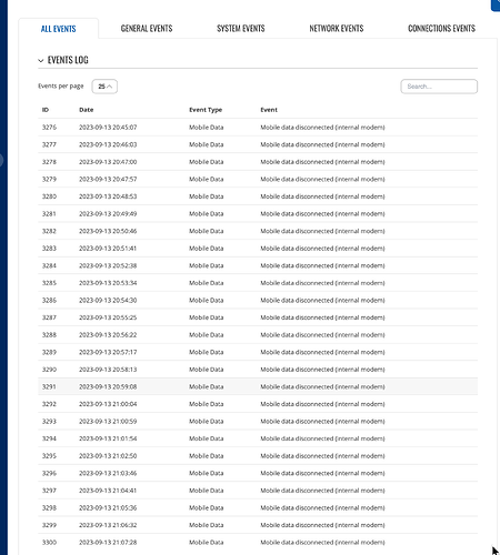

The device shows that it mobile connection and was trying to reconnect. It was able to reconnect in under 1.5 minutes. Are those disconnects always this short?
You mentioned that there are issues with the tower, maybe this is related to this?
As mentioned previously, it is possible that updating the modem’s firmware will help, so you can try that.
I think we confirmed the suspicion of it being the internal modem! :laughing:

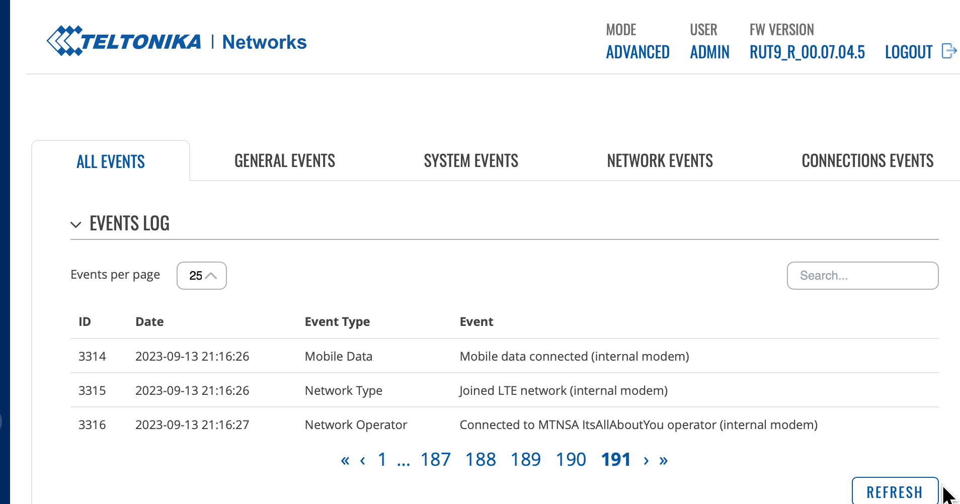

the above examples showed how the internal modem disconnected and then reconnected itself.
However, in these examples, it could not manage to reconnect itself, this time lasting for a few hours.
after a manual reboot, it connected successfully.
I think it is safe to say it is the internal modem firmware?
Now the big question: if I follow the upgrade directions as per the site link you sent, and the modem goes faulty permanently, that becomes my problem at my cost, correct?
What if the technical staff of the Teltonika distributor in South Africa conduct the upgrade and it goes faulty, who pays?
according to the link, I understood there is a higher chance of it failing during an internal modem firmware upgrade, than a normal firmware upgrade, is this correct?
Anyways, it has taken a while to get this to reflect clearly in the logs and I am happy we have this now…
