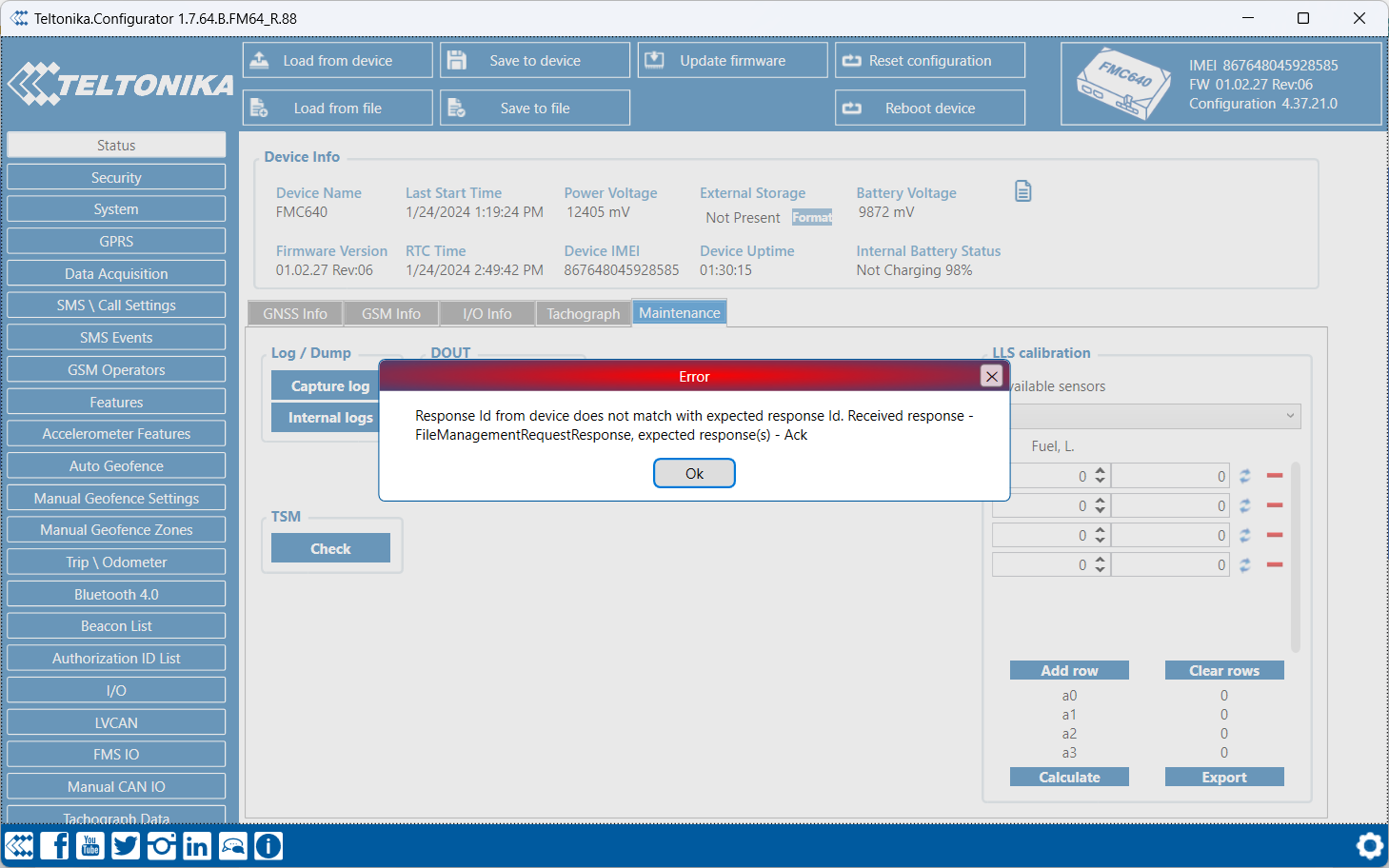

Response Id from device does not match with expected response Id
Response Id from device does not match with expected response Id.
I want to download internal log files and get this error.

Good day, it may be a bug from the device configurator. We would like to analyze your issue. Please contact your sales manager or create an HD ticket.
If you don’t have any contact with our Sales managers, please contact them on our official website https://teltonika-gps.com/ and click on the “Contact Us” button. When you click, please fill out the form and submit it. Note: as a topic, please choose “Vehicle telematics”. Or you can send an e-mail with a description of your situation to us: Teltonika - IoT, Internet of Things

Hi
Additional Information:
How to download internal logs for FMX6
Feature is available on FMC650/FMM650 devices, if:
  • Firmware 03.00.15.Rev.09 is used;
  • SD card is inserted into the device;
  • SMS/GPRS command “log2sd:3” to device is sent.
    How to download logs from device:
    -Via FOTA WEB, using Internal log download task
    -Via configurator, through the maintenance tab.
