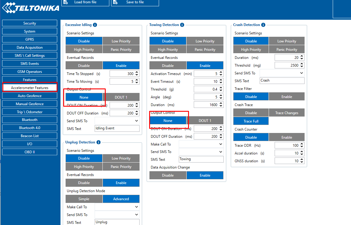

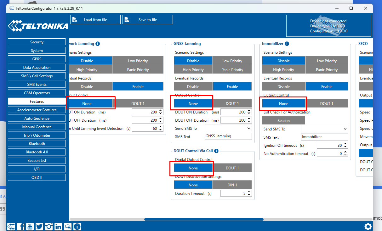

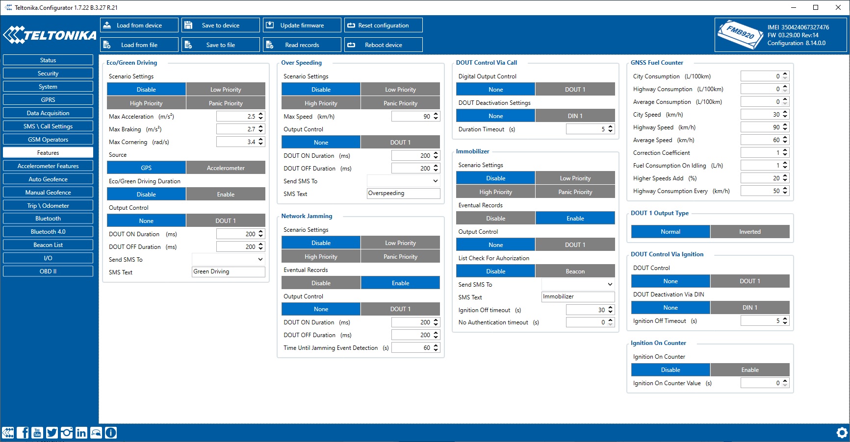

My settings are the same as the print screen.

Hi Mati,
This replay from the device DOUT1:SCENARIO only appears when you are using DOUT in any scenario.
