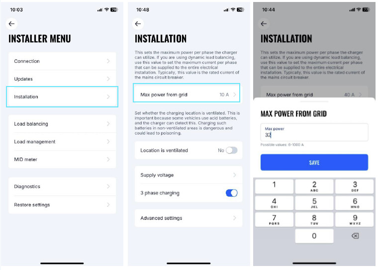

I have done all the initial settings in the installer menu but I haven’t found a place where to set the maximum charge power when using dynamic load balancing. I have 3x16A fuses so how do I limit the power to 11 kW?

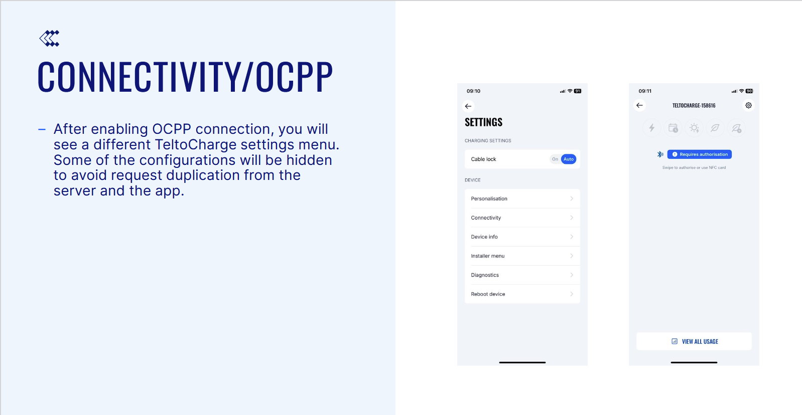

I may have misunderstood something but even if I have limited the current in the settings menu/load balancing to 16A it still shows occasionately max allowed current well over 20A when connected to OCPP. Why doesn’t OCPP mode limit the max allowed current according to the value in settings menu?

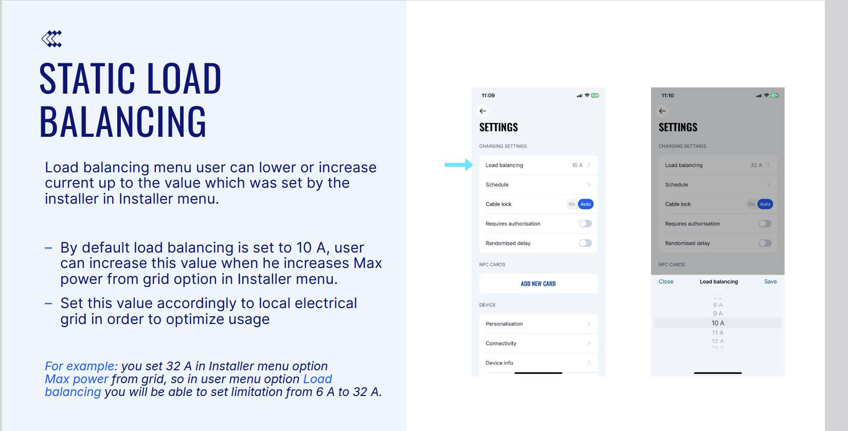

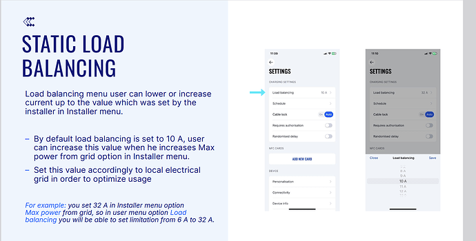

Max power from grid now in “Installation” settings, so this is max allowed current.
But the OCPP have a higher ground, and OCPP provider can change that settings.
P.S we updated our QUG for 1.14 FW https://wiki.teltonika-energy.com/images/f/f3/Teltonika_QUG_Updated.V.1.14.pdf
Feel free to check it out

Yes, I have adjusted this setting to 32 A (main fuses for the house) according to the instructions because I use dynamic load balancing. But since the charger has 16 A circuit breakers the maximum current for the charger should be limited to this value. I haven’t found any settings for this.
If the Charger is connected to the OCPP, then this feature is disabled, as the OCPP will be controlling output to the car

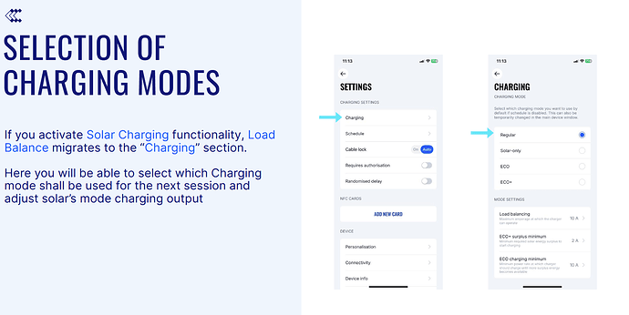

If the OCPP is disabled & Solar is disabled, then it’s possible to change Maximum output from the “user menu”
If the OCPP is disabled & Solar is enabled, then it’s possible to change Maximum output from the same “user menu” but the naming is changed:
