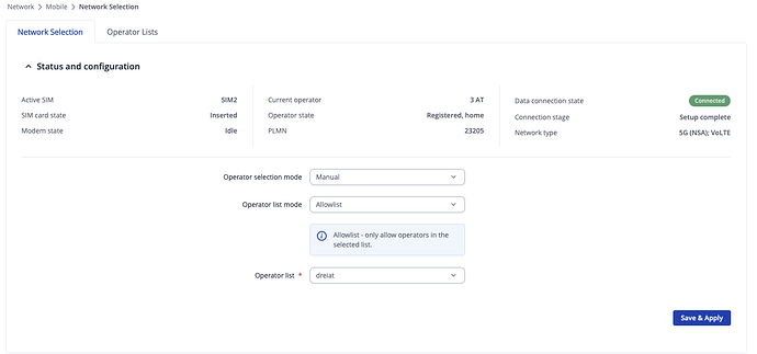

did you try a different cell tower with B66?
means tower locking like this?
I’ve got the problem that auto mode use the closest tower but it got a sad speed
so I must user another tower that is far away but better speed
it also can help that search cell tower what is close to you
