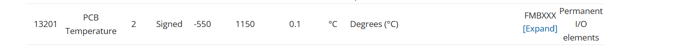

I need to operate a FMC234 in a hot environment and I would like to make sure the temperature does not rise above the limit of what the battery can handle. To do so I would like to check the temperature by setting a sms send event on the PCB temperature IO (which is visible in the Configurator IO tab). However I was not able to locate the Data Sending Parameters ID corresponding to “PCB temperature” in the folloing page https://wiki.teltonika-gps.com/view/FMC234_Teltonika_Data_Sending_Parameters_ID. Could you please share the ID ?

the ID is 13201
