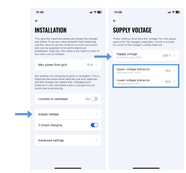

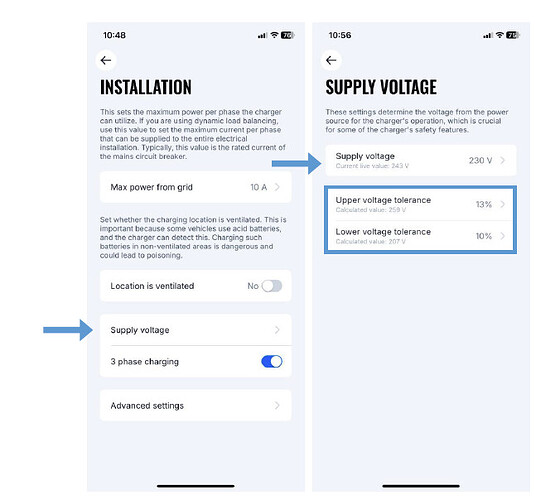

Good Morning,
Would it be possible for you to increase voltage tolerances?

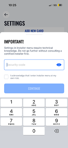

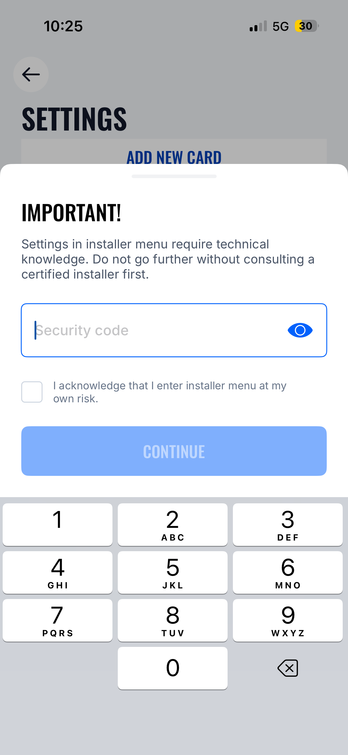

Is the “Installation” menu under the “Installer menu”? There’s no other “Installation” menu in the app it seems.
If so, where do I find the security code to access that menu (see screenshot)?

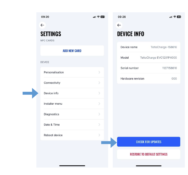

If you could provide me serial number, i will give you installer code
Great, but where can I share my serial number with you privately? I don’t want it to show publicly here.
You can write us an email
