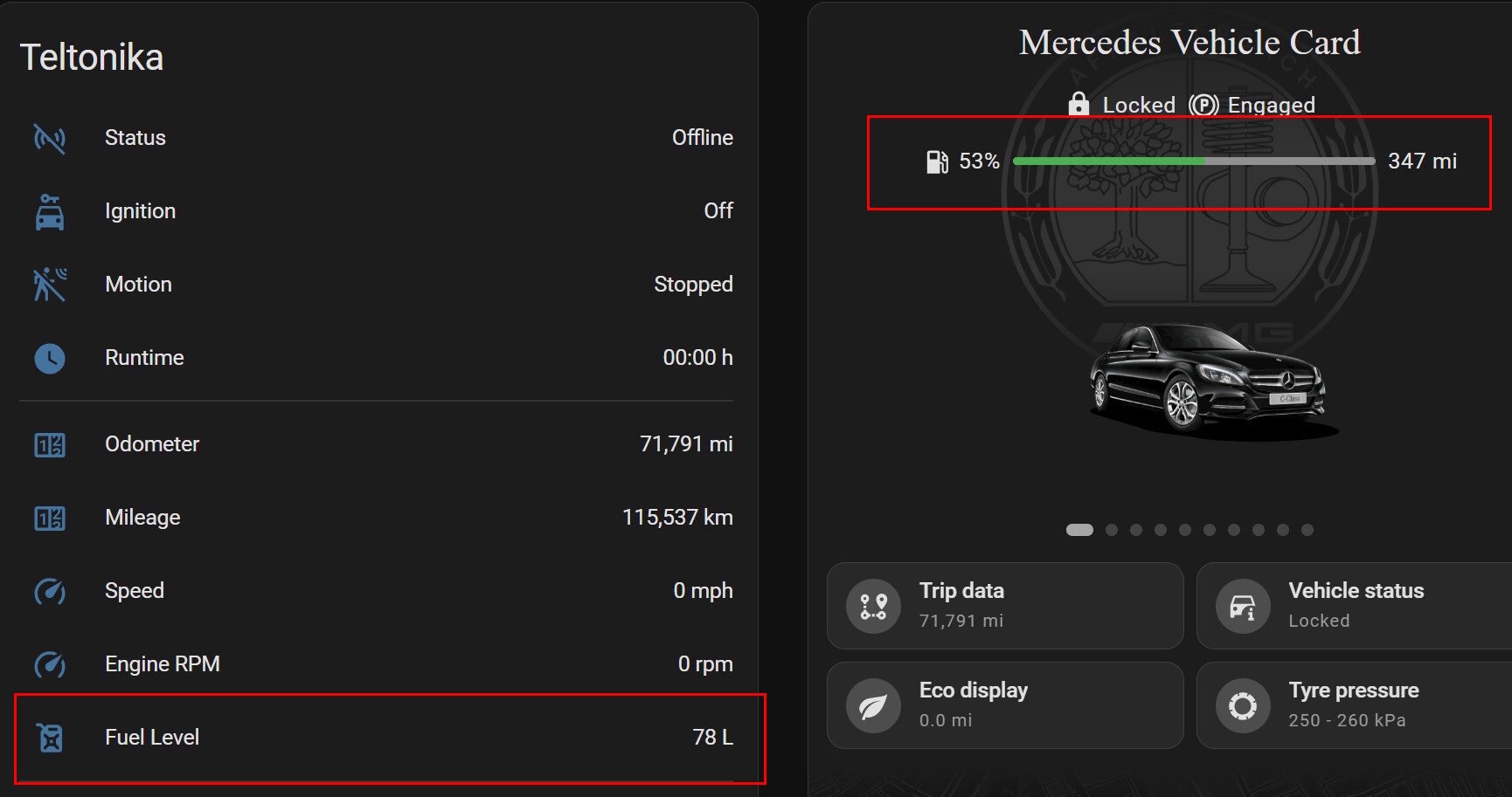

My Teltonika FMC003 is reporting weird (OEM) fuel level values which I can’t make sense of. My car is a Mercedes C-Class mk4 (W205) (2015-2019) which is found in the compatibility list and appears in the configuration options.
My fuel tank capacity is 66 litres and according to Mercedes Me cloud service (right picture) it is 53% full and this also aligns with my the fuel gauge on the car dashboard. So doing the maths, it should have about 35 litres in the tank.
However, the Teltonika FMC003 is reporting 78 litres (left picture). I’ve tested a few different scenarios but I cannot figure out what is going on. The ODB fuel number (litres x 0.1) reported by the FMC003 is illogical.
Note, the OEM mileage (11,5537 km) is correctly reporting. The issue is only with the OEM fuel level.

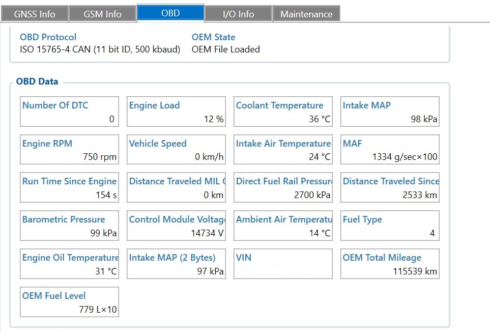

This is how the ODB data appears directly from the Teltonika Configurator app. You will note the OEM Fuel Level is shown as 779 (Lx10). In my application I am dividing by 10, which is rounded to 78 litres.
That said, my fuel tank only has a 66 litre fuel capacity. The FMC003 is reporting more fuel than the tank can actually hold :thinking:
I’ve captured device logs and I can see the correct OEM ODB file was pushed Mercedes-Benz;c 220;2014;mb_w205,mb_w204 and therefore it looks to be configured correctly. However, it still doesn’t report correct numbers.
