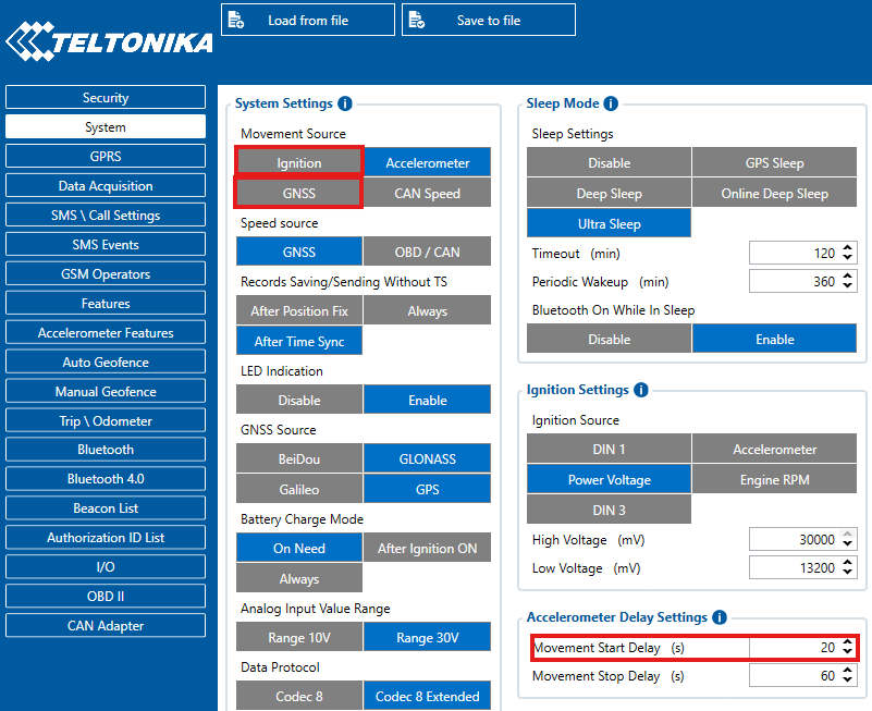

I hope you’re doing well. In the Movement Source settings, you can configure the device to use Ignition, Accelerometer, or GNSS.
If you’re using an accelerometer, you can adjust the delay settings to allow the device to detect movement after a specified period. Alternatively, you can switch to Ignition or GNSS as the movement source.

Thanks for your reply. I understand about Movement Sources and the one I am using is Ignition.
However my question was about waking up from Ultra Deep Sleep. If my reading of your documentation is correct, and after experimentation I think it is, the accelerometer will wake the device from UDS regardless of Movement Source.
So if the device is in a boat that is ‘parked’ on its mooring and the boat moves around a bit,which they always do, then the accelerometer will detect this and wake it up. That means that it will report pretty much continuously, more so than when not in UDS! Until the internal battery is exhausted, if course.
The 60s accelerometer delay isn’t going to help. What’s needed is a way to disabled the accelerometer so the device stays in UDS until ignition is turned on again.
