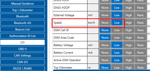

If you are receiving GPS position but not GPS speed on the FMM230, please check the following:
  1. IO Settings: Ensure that “GPS Speed” is enabled in the IO tab and set to an appropriate priority (Low/High/On Change) to be included in the data packets.

Enable the speed from the IO and look for AVL ID 24
