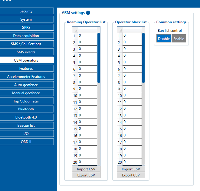

Hi @Win
The device will automatically set its mode depending on the location, for example you are now in your home country the mode will be home if you go outside of your contry the network connectivity will be roaming, you can also add the operator code here
Configuration of data sending of the device depending on the network mode.
