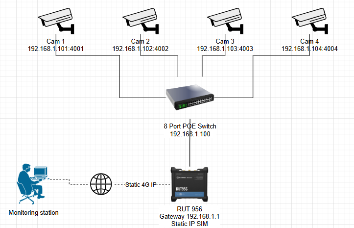

Apologies, at the time I was still drawing the diagram, Please find attached existing network Topology of each remote monitoring station.
Every station is the exact same, only difference being the Fixed IP Sim Card, which is how these things are monitored by the central monitoring control room so no ability for VPN sadly, however if the Starlink can integrate with its standard dynamic IP. and the end point being the Static IP of the SIM on the RUT 956’s.
I need to work in a solution to have these remote monitoring stations accessible by Starlink and Wifi-bridge links.
