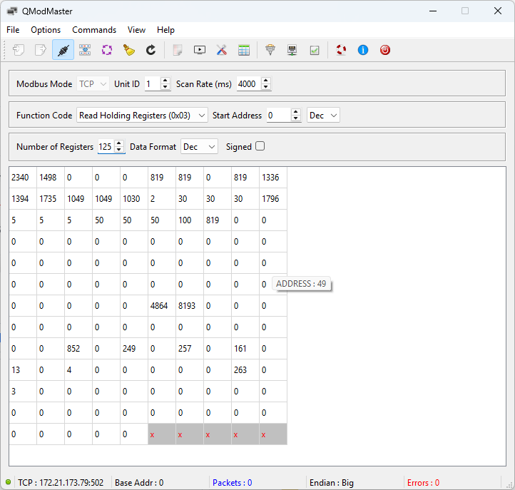

I use qModMaster to read registers from PLC using the serial port of the router, this has worked since several years ago.
The router answers Ok with the firmware version RUT9M_R_00.07.06 but with the firmware version RUT9M_R_00.07.24, it truncates the answers if the number of registers is > 52.
I suspect this problem has appeared on the last version due to the fix “Modbus TCP over Serial Gateway: fixed single ID option not working”.
