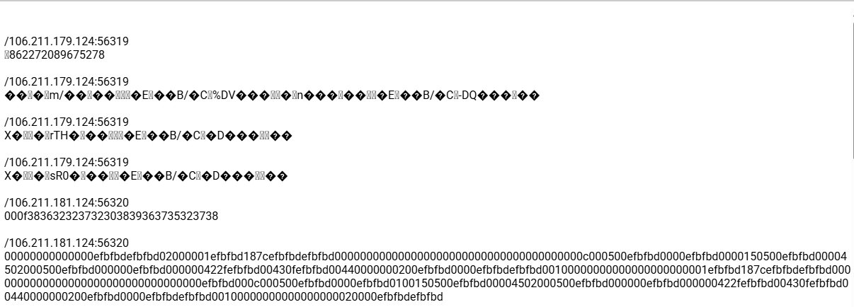

  • On the RS232\RS485 tab, the available RS485 modes are only: Log Mode, NMEA, LLS, TCP/UDP ASCII, and TCP/UDP Binary. There is no “Modbus” mode.
  • In the I/O menu there is no Modbus / RS485 register-mapping section.

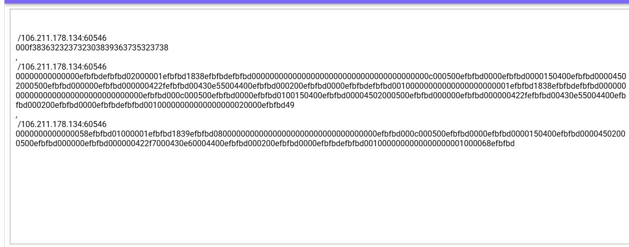

  • When I use TCP/UDP ASCII mode and forward data to my server (port 8012), I receive corrupted/garbage bytes (repeating “efbfbd” pattern) instead of clean Modbus register values.

Below I attached the server packets I received in my server side…please consider this
