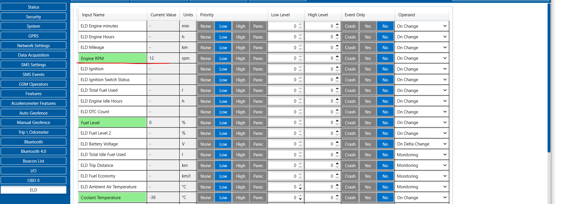

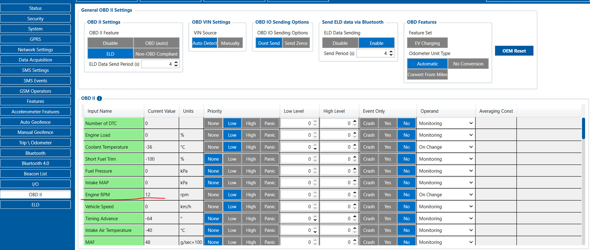

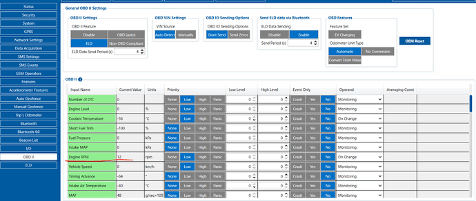

I’m trying to make an integration with FMM00A tracker for our Android app. I’ve set up Teltonika’s configurator, updated the tracker’s firmware to the latest available revision (04.02.00 REV 602), and attached FMM00A to the J1939 simulator that I have. The problem that I’m struggling with right now is that the fields that are clearly visible in Configurator are not present in the JSON that gets advertised by FMM00A via Bluetooth.
E.g. see the screenshots that I’ll attach to that topic. Engine RPM is clearly visible on both OBD-2 and ELD tabs and it corresponds to the value generated by the telemetry simulator. But the JSON that I am receiving from FMM00A contains an empty string in the obd_rpm field.
What could be wrong? Am I missing some field-level setting that will add this field to the JSON being advertised?
