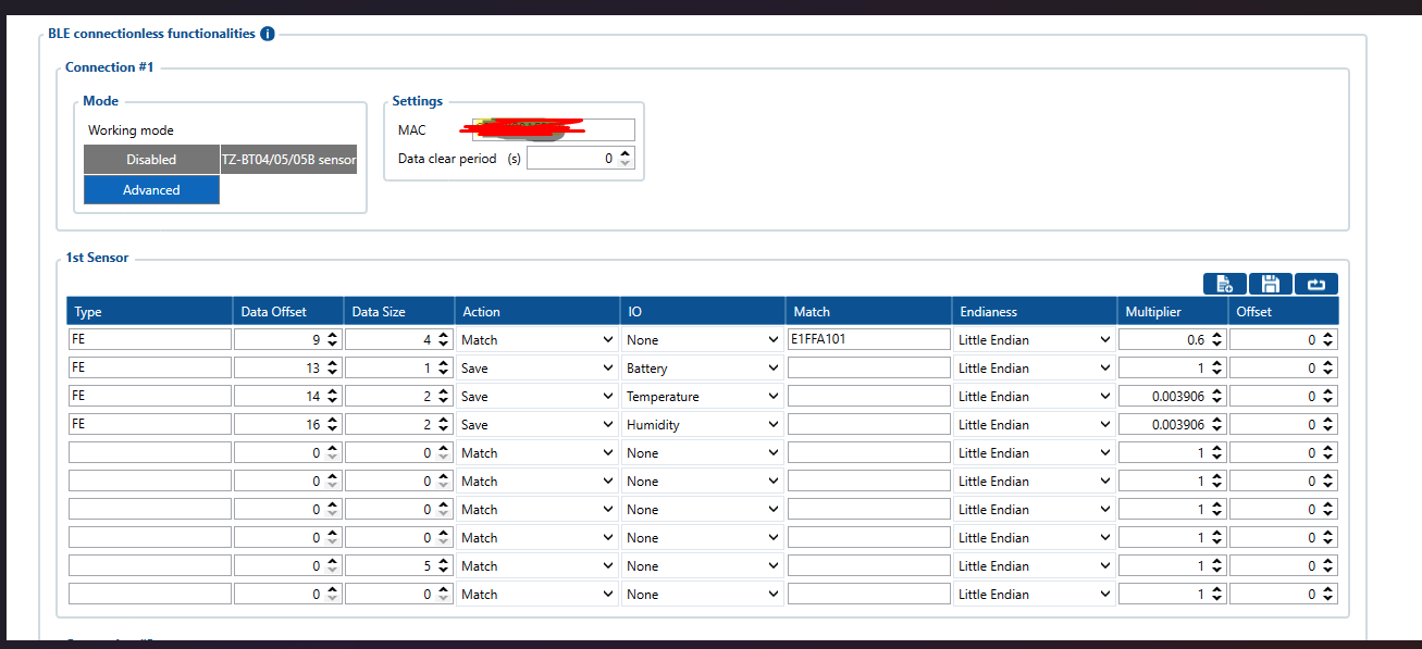

Good day, if you are using the Temperature and Humidity sensor for Minew please find the details below
  1. You need to create a preset according to our wiki page: How to add a BLE preset to the configurator - Wiki Knowledge Base | Teltonika GPS (teltonika-gps.com)
  2. You need to have the protocol from the manufacturer.
  3. Create the preset according to the protocol of the sensor.
Below is the preset created for Minew Temp and Humidity Sensor.

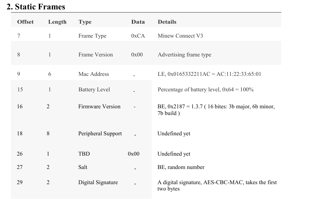

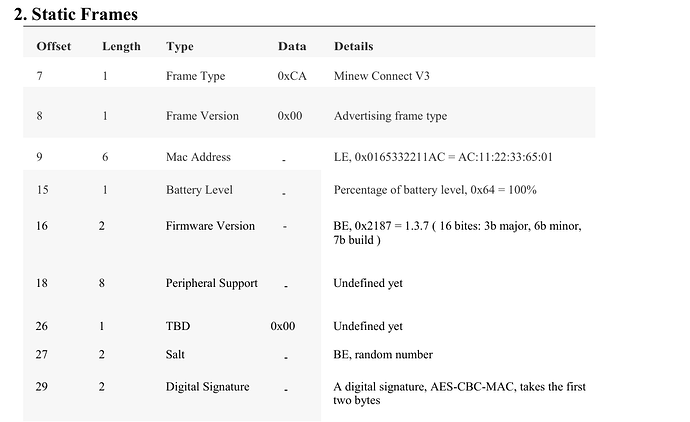

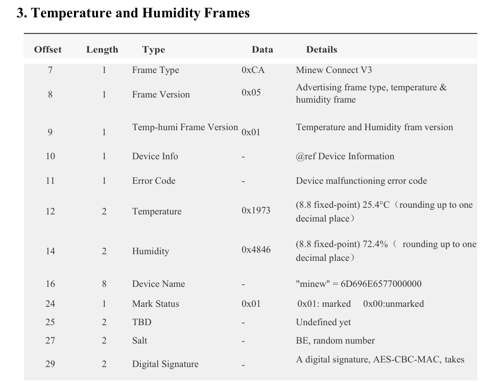

Hello Maynard,
Hope all is well, I have the protocol from the manufacturer, but from the picture that you provided, the data offset is different.
Looking forward to your reply.
Hi
The preset is for Minew S1 BLE sensor, please try to create a preset according to sensor’s protocol.
Best Regards
Maynard C.
