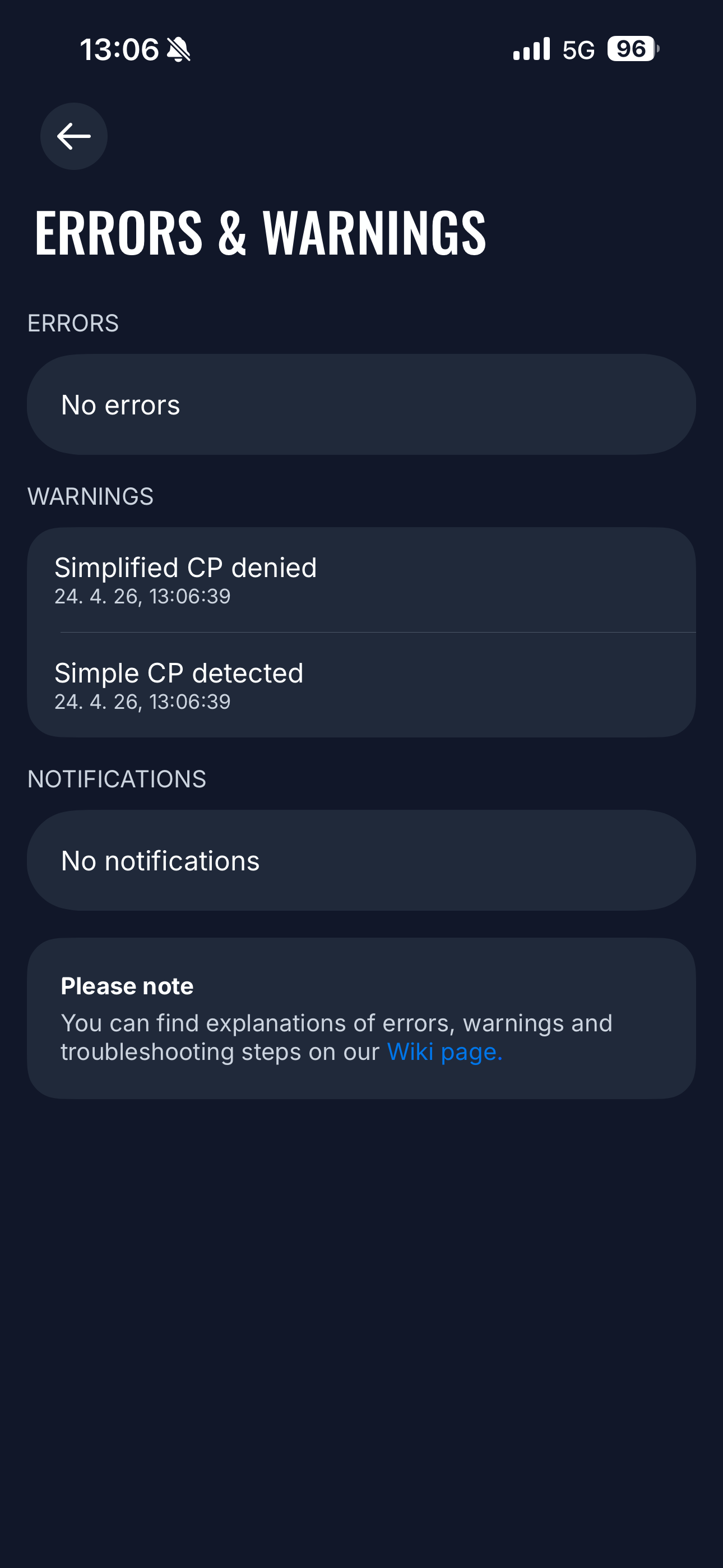

we have recently installed Teltocharge at our office. There seems to be an issue with Mazda 6e connectivity as it always displays the Simplified CP detected / Simplified CP denied. The car charges normally on other chargers.
Charger firmware is latest. If Simplified CP is enabled, car only charges on 1 phase 10A, which is too slow at 2kw.

My apologies about slow response.
We had similiar case with Mazda 6e with communication between EV and EVC station. The previous cases very related to early Mazda 6e charging control module not engaging correct state at the start of charging session. Maybe you could share datalog from the EVC station as without device information? You can find it under settings and diagnostic window. If possible please share this lod directly to our support email: support.energy@teltonika.lt
