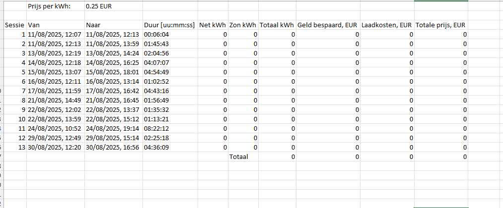

below is an extract of the data that I can download from the app, it only shows timing, no kwh
is this the situation that you have mind?
Yes, this happens if the configuration is bad as stated previously.
