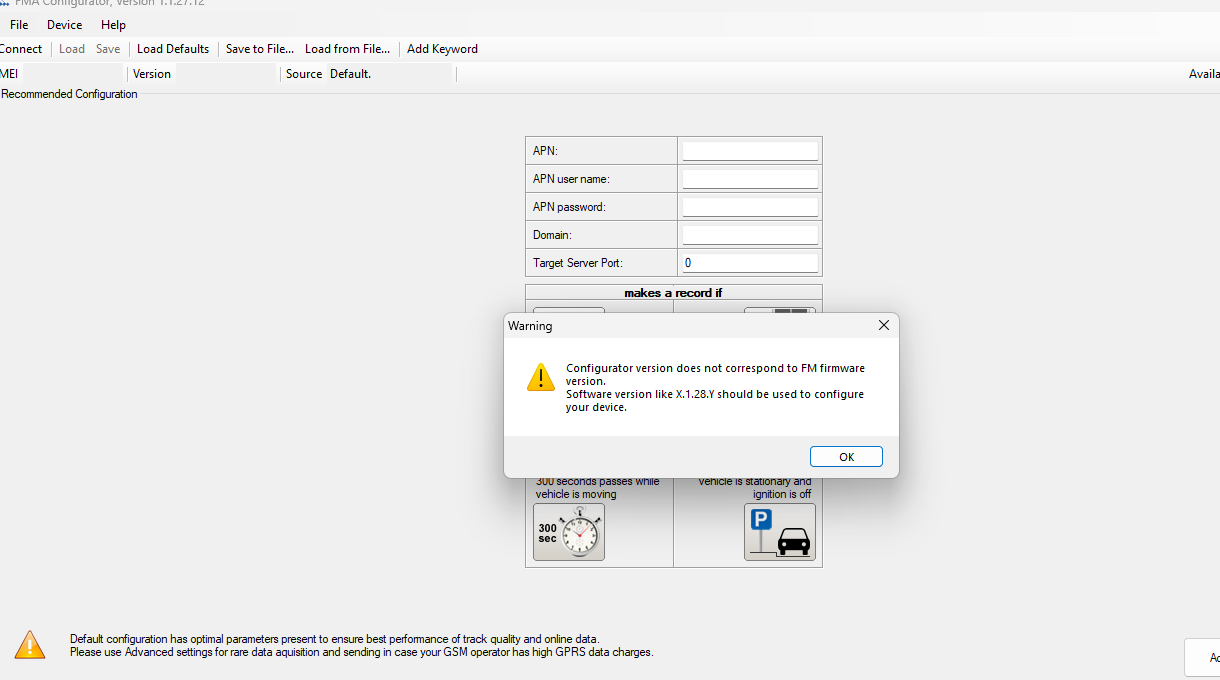

We got an FMA120 device from the field, and we are not able to log into it.
We have the following message:
The technician surely at one point upgraded this device to a firmware that no longer recognizes the latest firmware of the device.
i would like to know how to go about this issue and have the device connected to a configurator.
Your answers and help are very much appreciated.
Hello Forsuh,
Thank you for your message,
It’s likely that there’s a mismatch between the Firmware version running on the FMA120 device and the Configurator Tool you are using.
I suggest that you contact your Teltonika Sales Manager to request the Configurator Tool that’s compatible with the Firmware version currently running on the FMA120.
