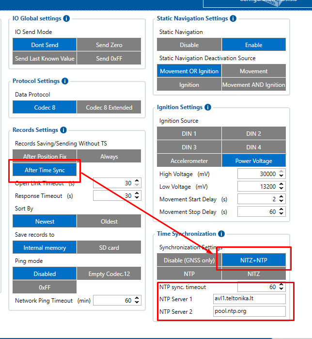

Good day, did you check the device configuration, from the record settings kindly select Ater time sync so that records can be saved if the device already syncs its time to the NTP server or through NITZ you can also test the configuration file below:
For your reference, you can visit these links :
  1. Tim Synchronization FMC640 System settings - Wiki Knowledge Base | Teltonika GPS (teltonika-gps.com)
    2.Record Settings FMC640 System settings - Wiki Knowledge Base | Teltonika GPS (teltonika-gps.com)
Note: If the issue goes any deeper and need further assistance from the engineers you can create a ticket through Helpdesk or contact your sales manager.

I applied your changes and so far it seems to work.
I only have one tested dataset so far and this included extremly bad connection (i sent an sms to retrieve a paramater and had to wait like 4 minutes to recieve an answer).
I got a gps coordinate like 5 kms away after but the missing points are trasmitted right now so the route gets populated still.
Still those 5kms difference seem to be a lot. Is there an option to send like the most current package and then fill up with the oldest ones?
Yes there is an option like that:
Select the Newest to prioritize sending the NEW records first followed by the OLD records.
Wiki page: FMC640 System settings - Wiki Knowledge Base | Teltonika GPS (teltonika-gps.com)
