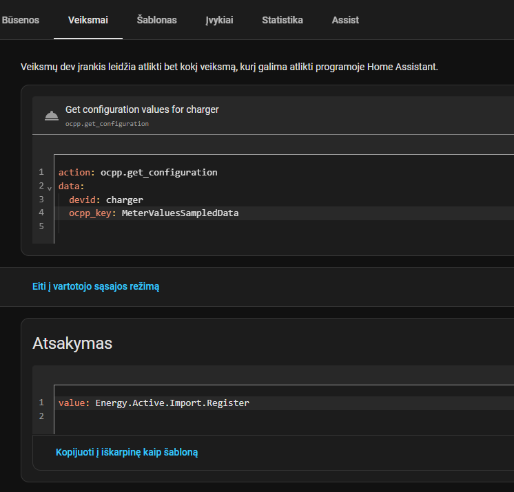

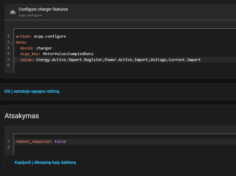

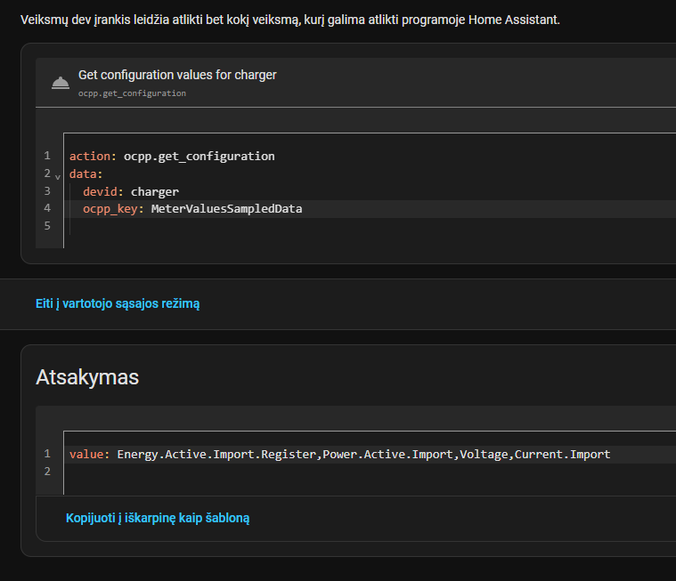

I’ve seen that some users had succses implementing EVC2 and older firmware versions of EVC1 to HA with all availabe measurands. I can only get default measurands “Energy.Active.Import.Register”, everytime then I enter new values to ocpp.configure they stay till the charger or HA reboots.

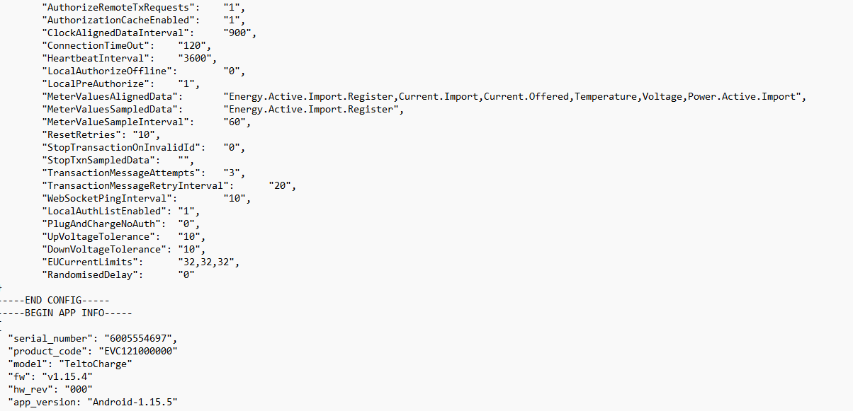

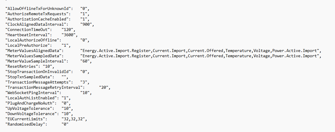

tried to look to the logs of charger before restart
after rebooting it defaults to factory settings:
