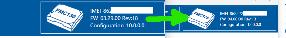

we have updated the firmware but it happens with both.
Why is that?
