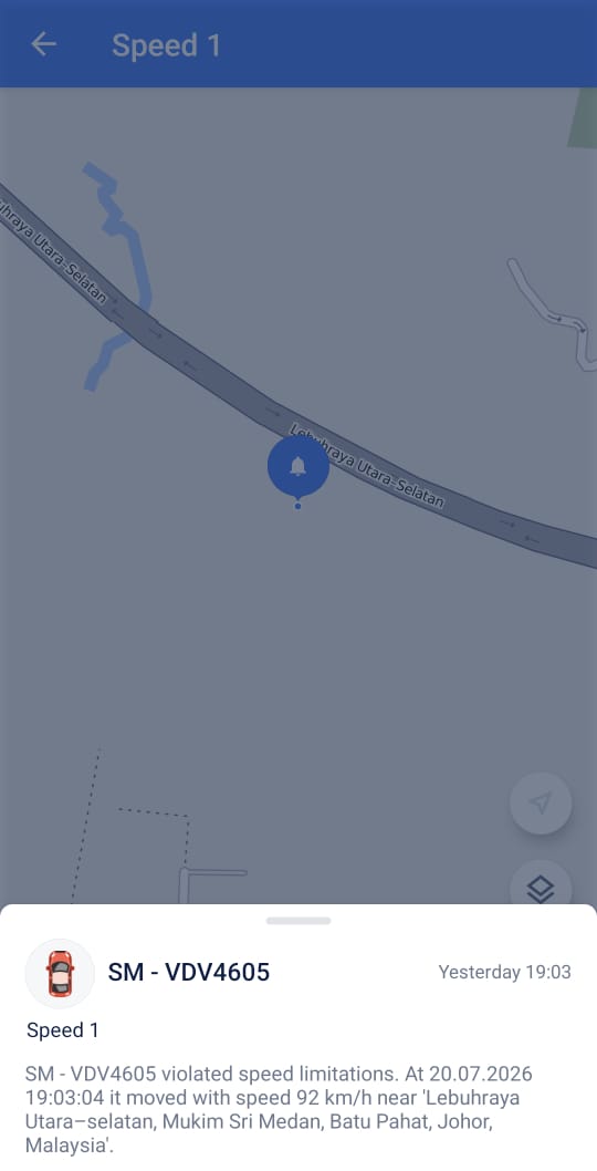

We are currently experiencing an issue with incorrect speed readings from our FMB120 devices connected to the Wialon server.
Since installing the FMB120 devices, we have been receiving frequent overspeed alerts whenever the reported vehicle speed exceeds 90 km/h. However, after verifying with the drivers, they confirmed that the vehicles were not travelling above 90 km/h at the time.
As a result, we are receiving false overspeed alerts, and the in-vehicle buzzer is also being triggered unnecessarily, causing inconvenience to the drivers.
Could you please advise if there are any configuration changes or recommended settings on either the FMB120 or the Wialon platform that could improve speed accuracy or prevent these false overspeed alerts?

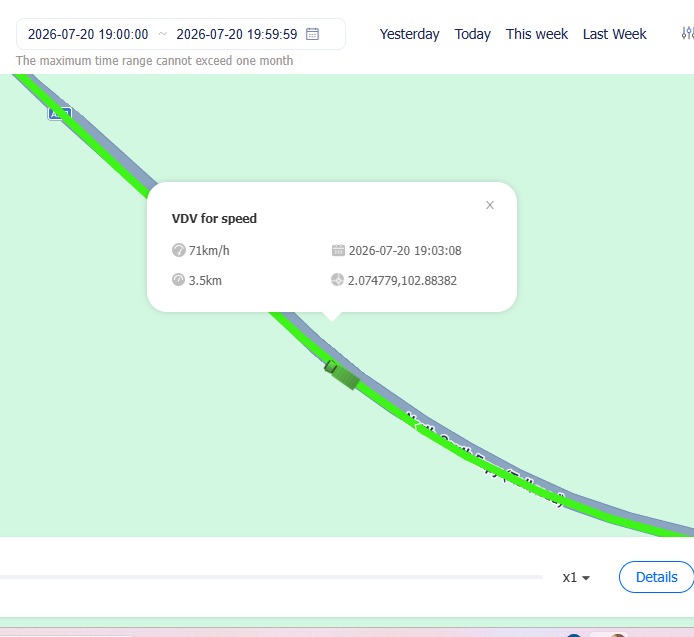

After checking with the truck owner, he informed me that another GPS tracking device from a different brand is also installed in the same truck. Surprisingly, we found that at the exact same date and time, the Teltonika FMB120 recorded a speed of 92 km/h, while the other GPS device recorded 71 km/h, which matches the driver’s claim.
Could you please help us understand why two GPS devices installed in the same vehicle would report significantly different speed readings at the exact same moment?
We would appreciate your advice on what could be causing this discrepancy and whether there are any settings or configurations on the FMB120 that we should verify.
