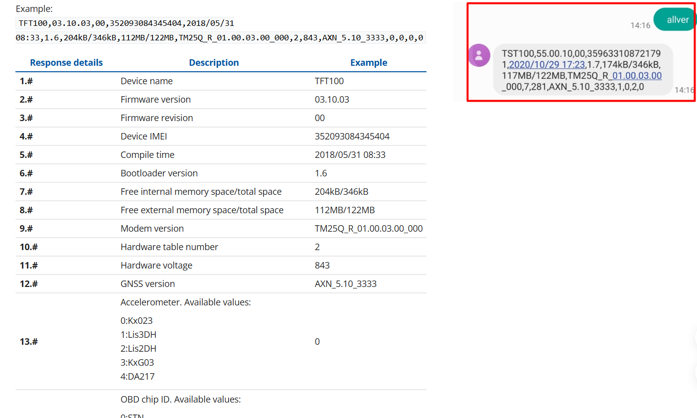

The IMEI belongs to the module that we used.
The easiest way to check the device model is from FOTA,
Otherwise, you can send a command to the device “allver”
Referance: FMB allver - Teltonika Telematics Wiki
