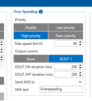

Please configure the overspeeding scenario
Change the Max speed value according to your requirements
And connect the buzzer using this diagram: Wiring-scheme-FMC125.jpg (2260×1394)
