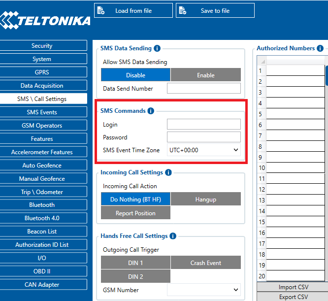

I am facing issue FMB920 device sms command deliver but not getting any reply ( getver)
i am facing issue FMB920 device sms command deliver but not getting any reply ( getver)
Hello @sparkgps
The device has specific format for sending sms command; as below
login password getver
If no login / password is saved in the device configuration, leave the two fields blank and send the command
space space getver
The SMS/login will be configured under the SMS/call settings. Please refer to the screenshot below for reference.
