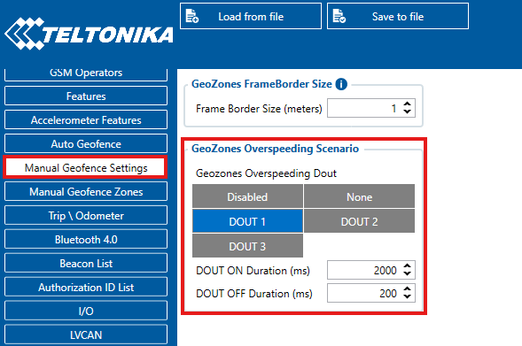

I hope you are doing well. Did you configure the Geozones Overspeeding Scenario from the configurator?
In this case, you should check if the buzzer was connected on the same DOUT mentioned on the configuration as well as the durating when this buzzer would be ON.
Hope this helps.

Hi Patrick,
Thank you for your reply. This is exactly what I want to do. Thank you for your support.
