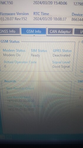

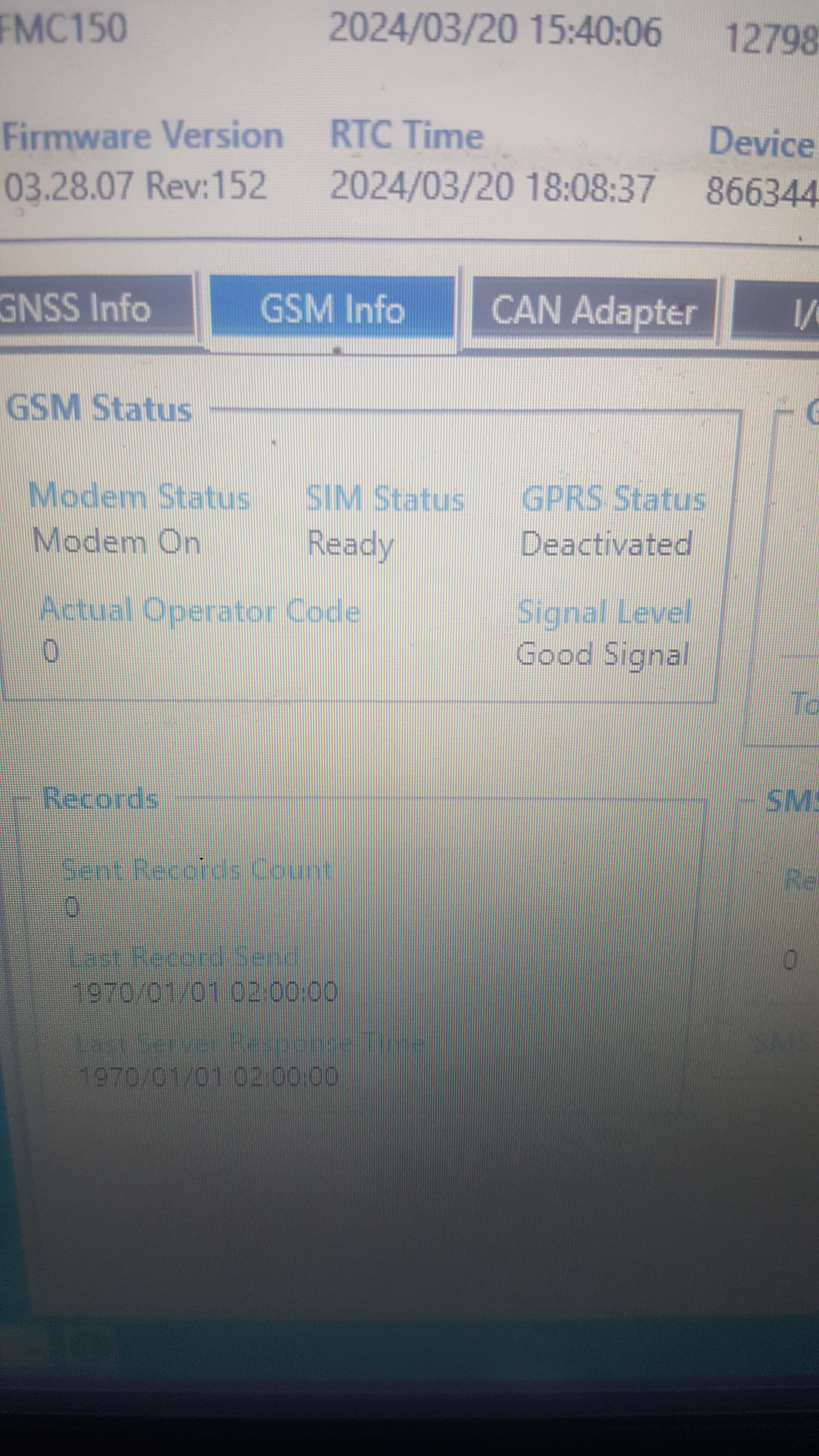

Attached is gsm info for fmc150. How do i make the device get actual operator code and activate gprs

Good day! I recommend you go to the I/O Tab and confirm if the device detected the ICCID and IMSI of the SIM. Once detected by the device, kindly set the APN of the SIM card you used on the GPRS Tab.
For more information, you may refer to this link: FMC150 GPRS settings - Wiki Knowledge Base | Teltonika GPS
